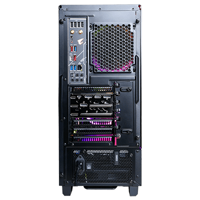

hmm ill have to check. i cant remember if its a 650w or a 600w but i will check. but it would be so much easier if there was a software where i can see it without taking the back off of my pc ;-;

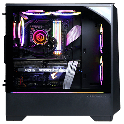

So The ram solution dident work
But this is my PSU i think its the problem
it says the model
it says the model at the top (Model No. EVGA 600 GD)
I can't find any reviews / tests about the PSU so it turns out to be a PSU I wouldn't buy even though it's cheap for a gold certified one.
Users saying it's very good is not a review / test.
The recommended PSU is 600 watts true but you have to take into account the rest of the components in general, it may be that the PSU is not delivering enough power for components.
650W or 750W it's better to have another 100 watts more.
