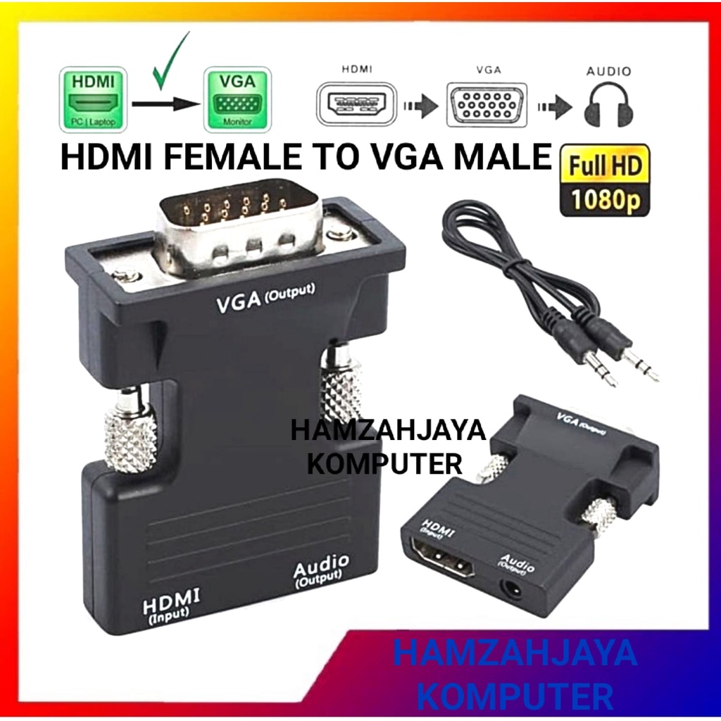

I have a PC that only have HDMI port and a Monitor than have only VGA port. I found two products that does the same but with different implementation. So I wanna ask, if I should get
1st Option. The one that has a HDMI cable already which I connect to my PC and then I need to insert VGA cable to the converter and connect it to my Monitor or
2nd Option. The one where I need to plug it in to the monitor and then insert HDMI cable and connect it to my PC.
1st Option: HDMI to VGA (with cable)
e198b0cb3806446b29e92a914b693191
2nd Option: HDMI to VGA (without cable)
Which design is more reliable in this case?
I don't believe there will be much difference. But you should be careful to make sure the second adapter would fit, on monitors with downward-facing ports there may be obstructions preventing such a bulky device from fitting.

Well in this case, i just find it a quite a hassle with VGA locking mechanism, and how all of my VGA cable are faulty, one cause discoloration another one cause my monitor to flicker and more (tried on some device with VGA port). I would buy a new VGA cable, but I have HDMI cable that work just fine because they havent been used in a while.
