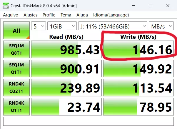

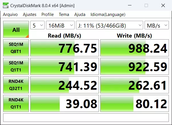

I bought a 10gbps Ugreen SSD Case and a 512gb Kingston NV2 SSD with 3,500mb/s read speed and 2,800mb/s write speed. The case came with a 10gbps cable from Ugreen. When I do the data transfer tests, the computer transfers to the SSD at a speed that varies between 50-200mb/s and DiskMark indicates 985mb/s reading and 146mb/s writing.
In the last few days I searched how to solve the problem and I realized that it could have all kinds of reasons, such as the storage controller, incompatibility between SSD and motherboard/case, and others that I haven't discovered yet.
The SSD is formatted as exFAT and Basic Data Partition.
What do you think is happening?
Unfortunately I don't have another case, motherboard, SSD or 10Gbps cable available to test the components one by one. I tested it on the USB 3 input of a Playstation and of someone else's computer and the results were the same.
