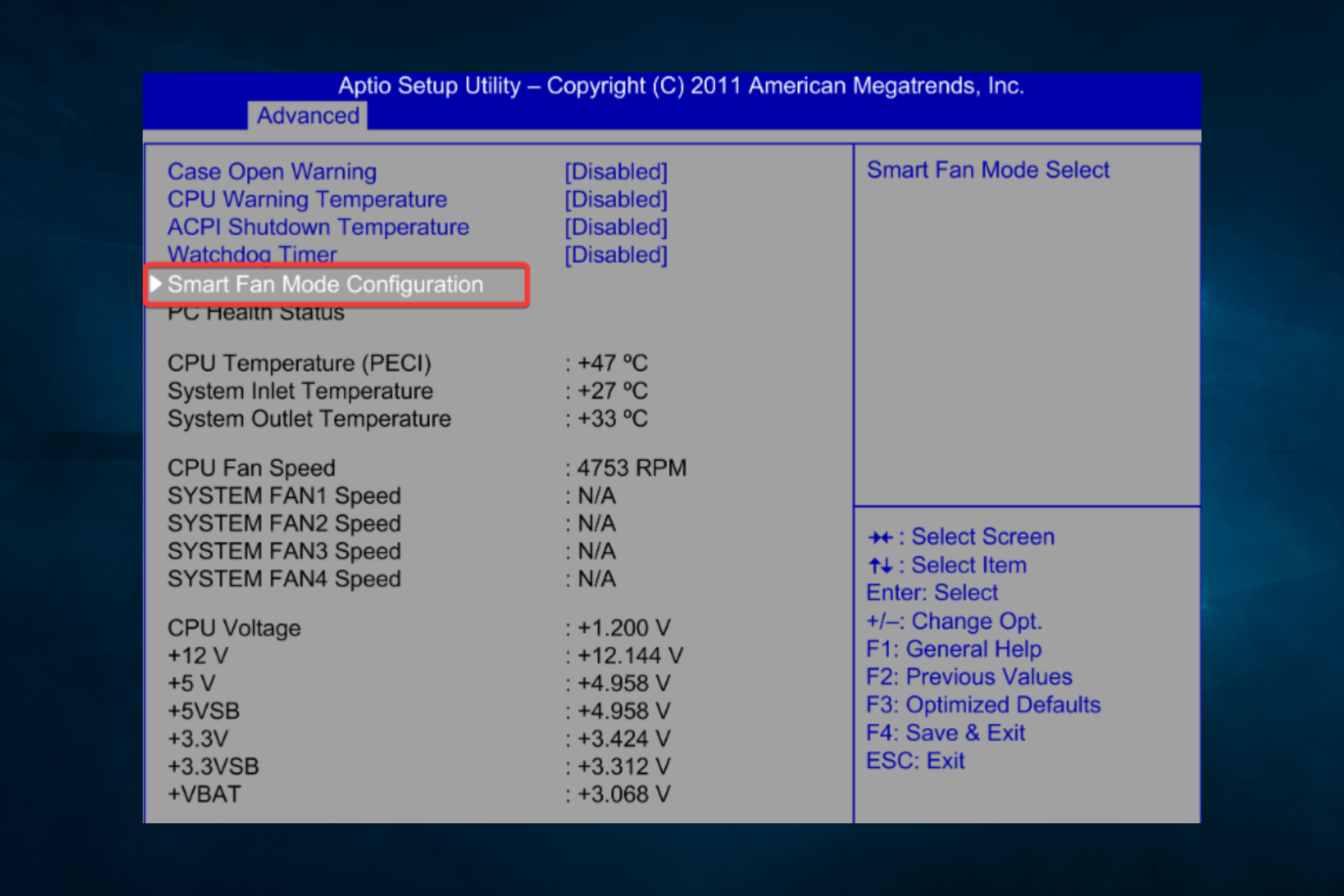

Yeah, do check fan rpm somehow or try force it to a 100% if you can, just to be sure.
H/W in the bios is it? 68c is too high in the bios if it is.

So it seems like the fan is not increasing speed to deal with the extra heat (locked to 40~50c) rpm speeds?. Thinking out loud, once it reaches that point the cpu is throttling? There could be a delay or incorrect sensor readings giving false temp numbers.
See what happens if youre able to increase fan speed.
