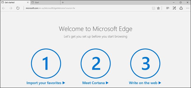

Now it's blaming Edge.
How to Reset Microsoft Edge in Windows 10
