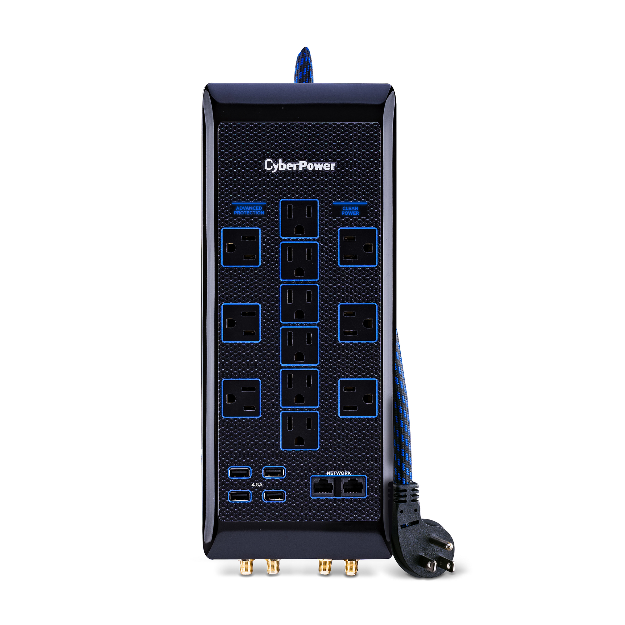

I am currently using this premium CyperPower surge protector to power all my PC parts:
Can someone please compare the power specs for both these products and tell me that; if I operate my 1600 watts PSU at full/near full load, my surge protector wont break and catch fire?
Some things that concern me the most is that the PSU says "24A" max output and the surge protector says "15 Amp Circuit Breaker"...
I have no idea what all that means. Just tell me if these two are safe to use together if I am mining with 4 GPUs and using around 1500 watts.
Since that is US voltage powerstrip, 120VAC at 15A -- maximum of 1800W. For continuous use, the recommended limit is 80% or 1440W.
There are no teardown articles to help you know what is inside that power strip. You are pushing beyond the 80% limit and you don't know if the internal components will overheat with the entire load of the power strip on a single plug. I wouldn't do it.
