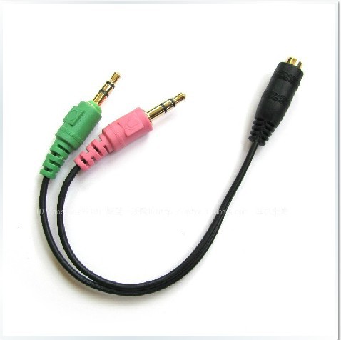

I also have the Tritton Detonator, but I already solved the dilemma. The problem is that the Detonator uses a 3.5mm 4-pole jack (shiny, silver sections on the male jack), allowing both the audio input and output to use the same cord. However, most PCs use separate jacks for microphones and headsets/earbuds which only use 3 poles. Solution number one involves buying a 3.5mm 4-pole female jack. Option number two requires using an audio joiner/splitter which separates the 4-pole line into two 3-pole lines. Either way, you'll have to pay.
Splitter/joiner
http://i01.i.aliimg.com/wsphoto/v0/916583103/2-in-1-Audio-adapter-cable-3-5mm-male-3-pole-to-3-5mm-female-4.jpg
Female jack/socket: http://www.amazon.com/Gino-Female-Headphone-Connector-Adapter/dp/B00DC4VGHC
The only caveat I've had with the joiner is that the mic input is converted from mono to stereo rather poorly. When listening to the microphone playback, no audio is recorded on the right channel. It is only audible on the left channel. For pre-recorded audio, you can separate the channels and delete the right channel, convert the track to mono, or combine the the channels. All options can accomplished in Sony Vegas or Audacity. I have not confirmed whether or not these solution are possible in other programs.
