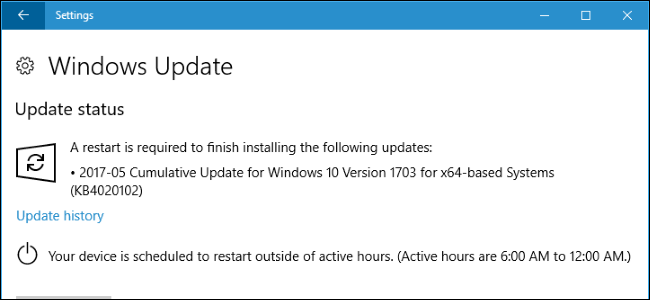

Set Windows update to only check for an install updates outside the time you normally would tend to be gaming or doing other important tasks.

OK - Done - Done and Done. Disabled system restore, Disabled drive optimization and adjusted windows update times.
