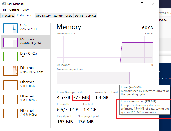

  • Try to temporary disable the page file on your system (No paging file option), restart your computer, enable the paging file (Automatically manage paging file size for all drives option) and restart your computer again.
  • If the problem of heavy loading of the computer by the Compressed memory process occurs only after waking from the Sleep or Hibernate mode (and disappears after the restart), try to download and install the latest versions of drivers for your disk controllers (ACPI/ AHCI / RAID / SCSI), hard drives and video card from the official websites.

compression will always exist in some state. its the first stage in what windows does with a closed program. If you run a program and then close it, instead of writing all the data back to the drive right away, WIn 10 compresses the data. Only if you run out of ram will it decompress the data and write it to storage. The idea being that if you open the program again, its much faster to do it from ram
it also decompresses the programs if you reopen them and the data is needed.
SO compression/decompress are normal. If the game you run uses tons of ram the PC has to move whatever was in that ram onto a drive. Even with 32gb of ram I still have compressed memory (though not a lot).
Turning it off could lead to other problems.
