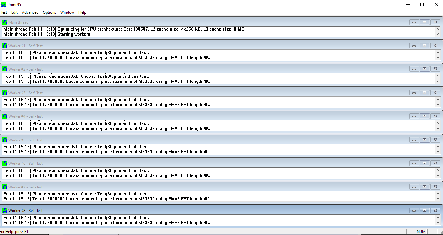

when you get home, run this overnight once you go to sleep
Prime 95 - https://www.guru3d.com/files-details/prime95-download.html
Prime 95 Instructions - https://appuals.com/how-to-run-a-cpu-stress-test-using-prime95/
it will check CPU, ram and power supply.

unless you get rounding errors in Prime 95, I would run this the next night as it can take a while to run too - Try running memtest86 on each of your ram sticks, one stick at a time, up to 4 passes. Only error count you want is 0, any higher could be cause of the BSOD. Remove/replace ram sticks with errors. Memtest is created as a bootable USB so that you don’t need windows to run it

Then I ran the Prime95 test this night until now. Ran into one error that says:
“FATAL ERROR: Rounding was 0.4920196533, expected less then 0.4
Hardware failure detected running 4K FFT size, consult stress.txt file”
It happened 7 minutes in according to the log!

I ran a shorter test of Prime95 again, and got an Error. It says:
FATAL ERROR: Rounding was 0.499998954, expected less then 0.4.
Hardware failure detected running 6K FFT size
So this time it said 6K FFT size, while the first error said 4K FFT. I don’t know if it’s a big difference?
Most of the time, adding voltage to ram is answer but...
Prime95's stress test feature can be configured to test various system components by changing the FFT size. There are three pre-set configurations available:
  • Small FFTs (Primarily tests FPU and CPU caches)
  • In-Place FFTs (Maximum power consumption; tests FPU and CPU caches, some RAM)
  • Blend (Tests everything including RAM)
On a completely stable system Prime95 will run indefinitely. If an error occurs the stress test will terminate indicating the system may be unstable.
https://www.tenforums.com/tutorials/16474-prime95-stress-test-your-cpu.html
From what I can tell, 4k & 6k are small FFT
If you only running small it could be the CPU. So you need to give CPU more voltage, not the ram (memory controller is on CPU)
