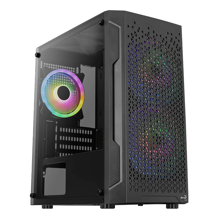

Hello, i was wondering, is there any rule to mounting my front case fans. Does it matter if i install it inside the bracket or outside of it? The case came with case fans pre installed which were mounted outside of the bracket which am switching out. Would like to fit them on the inside of the bracket if doesn’t cause any troubles since it makes it easier to replace them if i need to replace them again. Thank you!

Hello and thank you for the answer. The case i have is aerocool trinity mini which has the front panel shaped in a way so it can fit outside of the bracket without problems. If i understand correctly it should be fine for me to install the fans on the inside of the bracket as long as i have enough room?

I guess the above link brings up maybe a new issue. Do you care if "allows for a clear viewing of your front LED fans". You would want the fans mounted close to the mesh if you care about seeing them.
