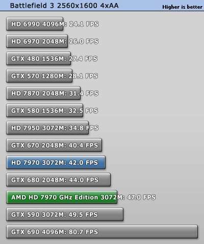

Data doesn't lie, anything above 1080p you are better off with AMD's 3GB Vram and superior bus speed. Not to mention 7900 series have more overclock headroom due to unlocked voltage.
Your charts did not show any wall at all. It showed the 670 performing normal on both charts. It did show the 7970 GHz edition performed quite well, but when you OC the 670 to a GHz, it will perform almost as high (about the same difference as the non-GHz 7970 to the non OC'ed 670).
The only thing holding back performance at that resolution is bandwidth, and the loss in performance is quite small.
Look at it again:
Instead of looking at Ghz, look at 7970 vs 670.
1920X1200 4X AA
GTX 670: 65.9 FPS > HD7970 64.4 FPS
2560X1600 4X AA
HD 7970 42 FPS > GTX 670 40.4 FPS
Notice how the table turned on 670 when the resolution went from 1200p to 1600p?
It is that you are paying the same for less FPS, with 8X AA the gap will be even bigger. Maybe there isn't a wall, but HD 7900 series performs much better at high AA & high Resolution.
Omg, 1-2 FPS, the game is unplayable.

You also should realize the vram size would not make up any of the FPS. In fact, the 4gb cards either perform the same, or 1-2 FPS slower. http://www.guru3d.com/articles_pages/palit_geforce_gtx_680_4gb_jetstream_review,21.html

HD 7970 pulls ahead of GTX 670 on higher than 1200p resolution.
These benches are run at stock clock rates, HD7970 price is not much higher than 670 while 7950 prices are $70 lower at least:
HD 7970 series comes with a 915 stock clock and can be overclocked to 1150-1200 on average(check OCN)-> 25%-31% Overclock
GTX 670 comes with a 980 boost clock at least (the average kepler boost is another 90 higher than that), so they run these Benchmarks at about 1050 Mhz clock minmum, your chance to get a 1300mhz GTX 670 is about 50/50 depend on silicon luck & thermal throttling and that's only a 21% Overclock.
So when Overclocked), the edge to 7970 will be larger and OCed 7950s will reach or surpass 670 in performance while costing much less.
In Conclusion, GTX670 is not the optimal price/performance GPU for 1440p gaming with high AA.
