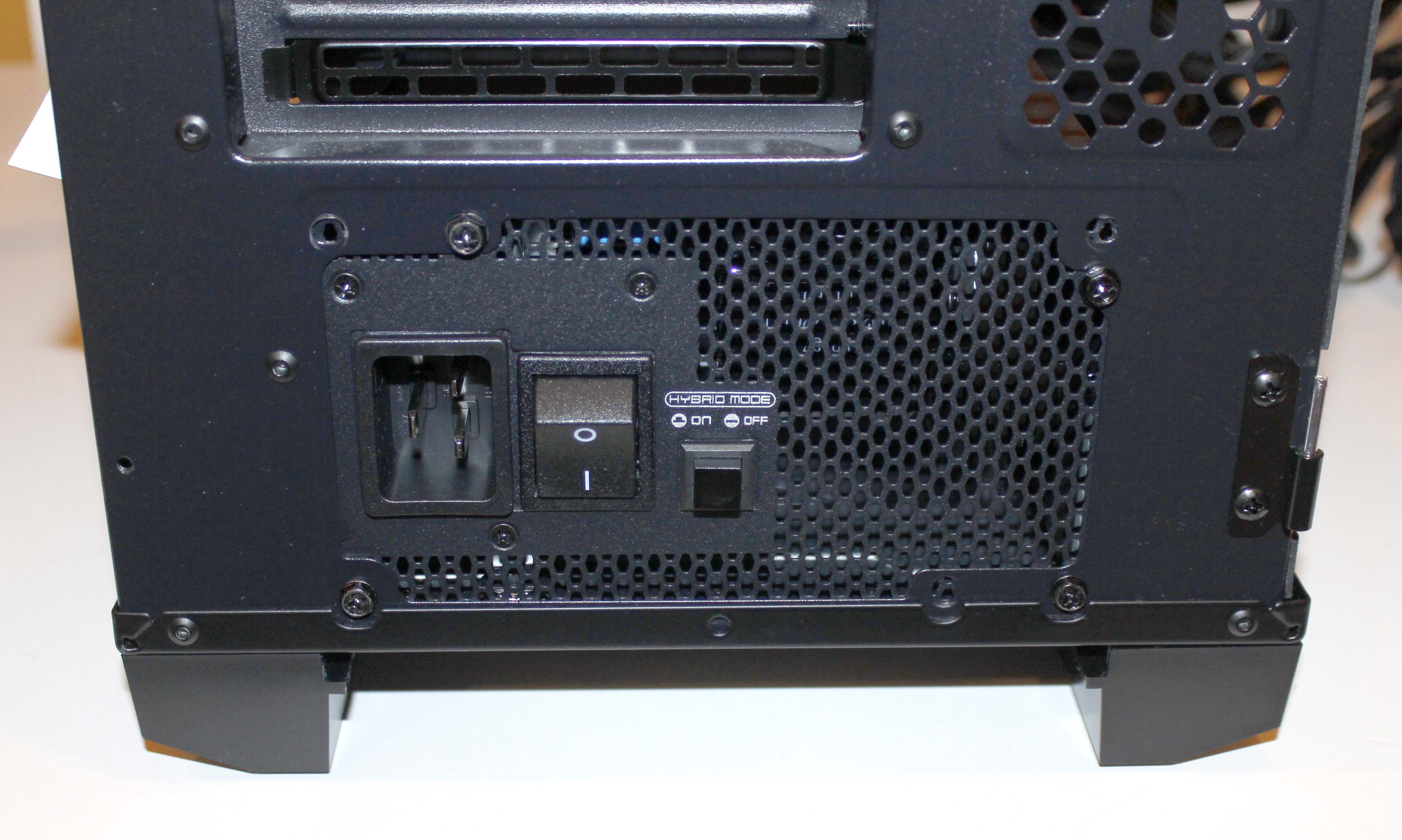

I guessed "normal" probably means to set the switch to off.
This.

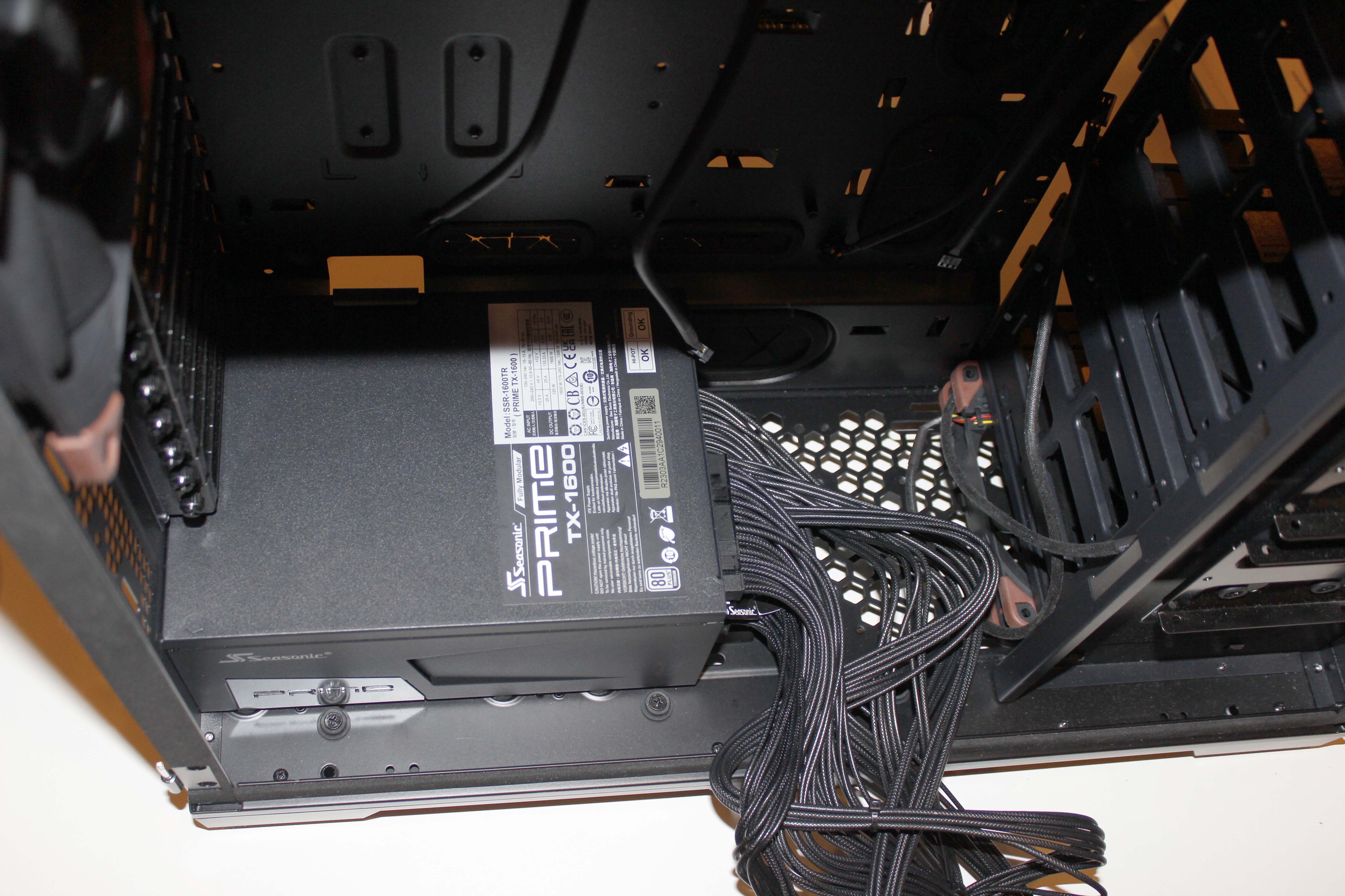

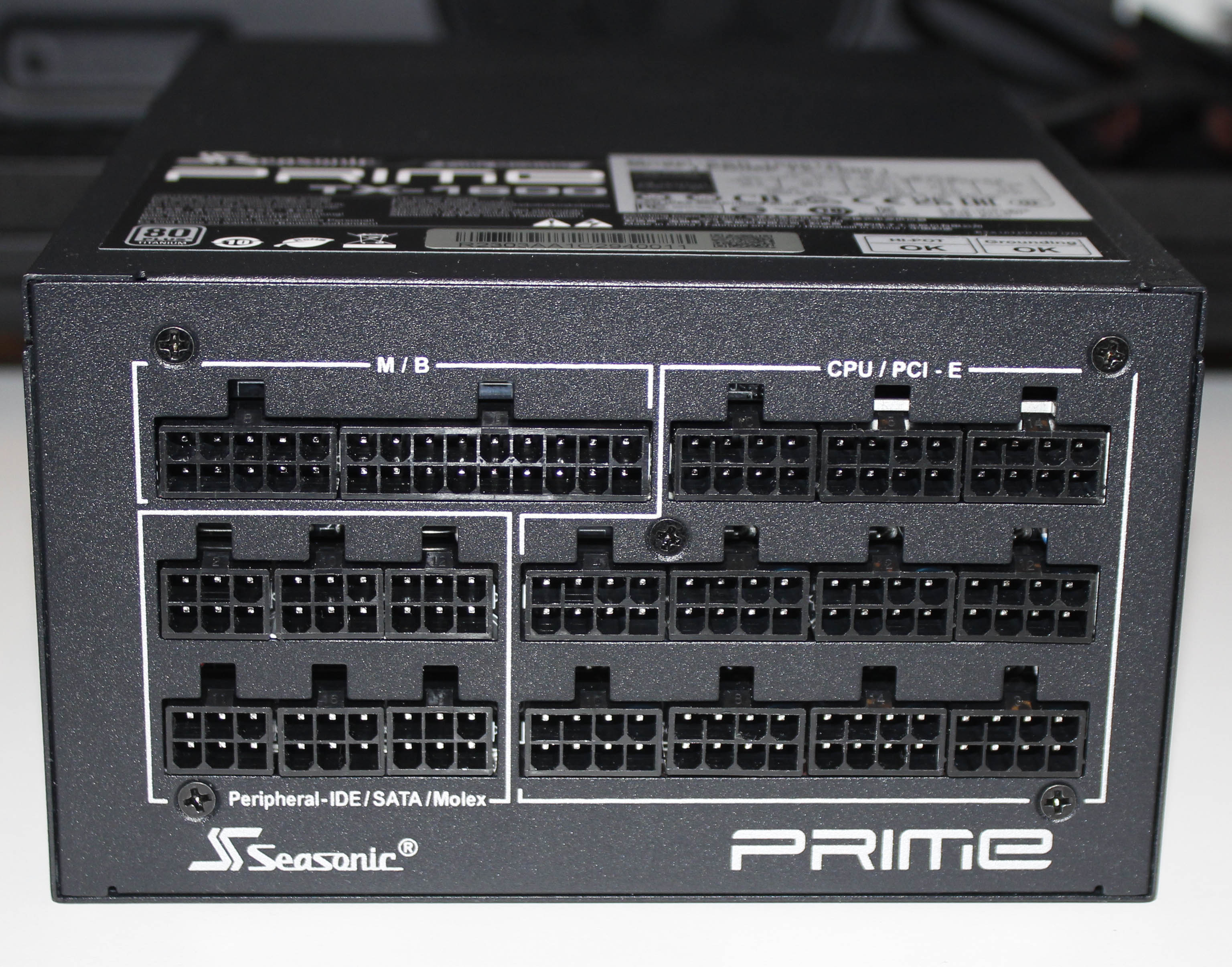

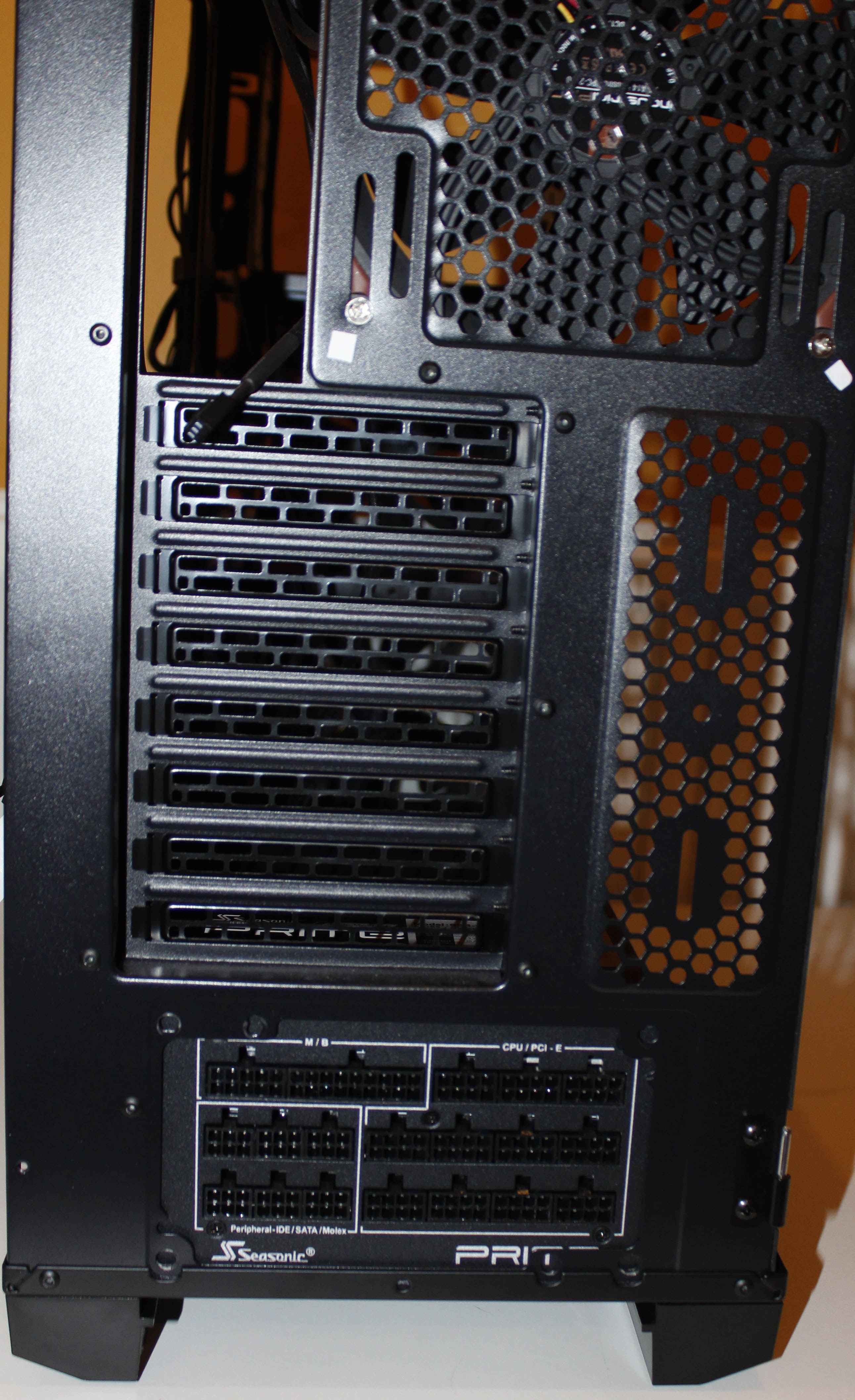

can I get away without using the entire lowest row of cable sockets on the PSU?
anyway, something has to give, the question is what?

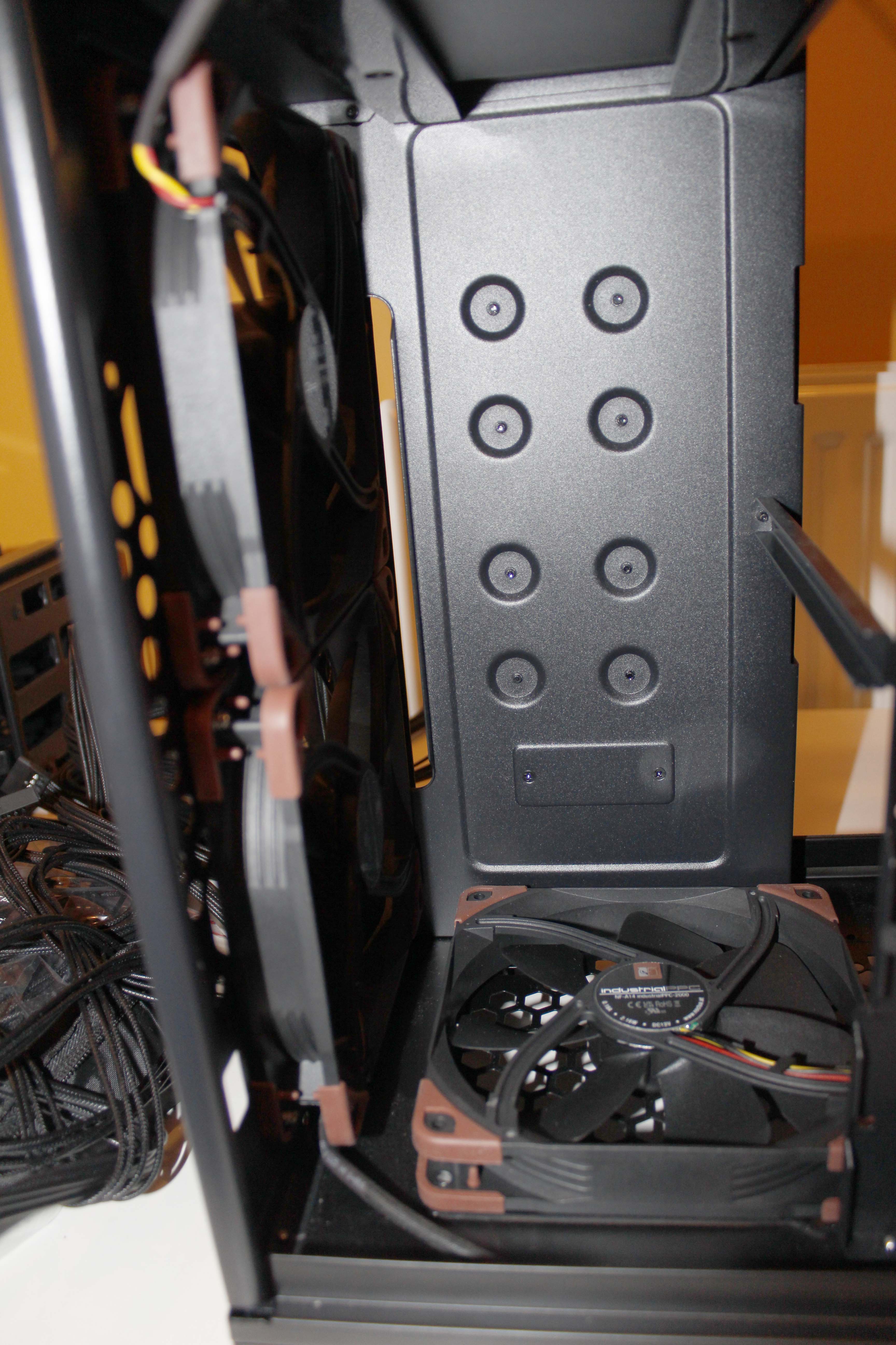

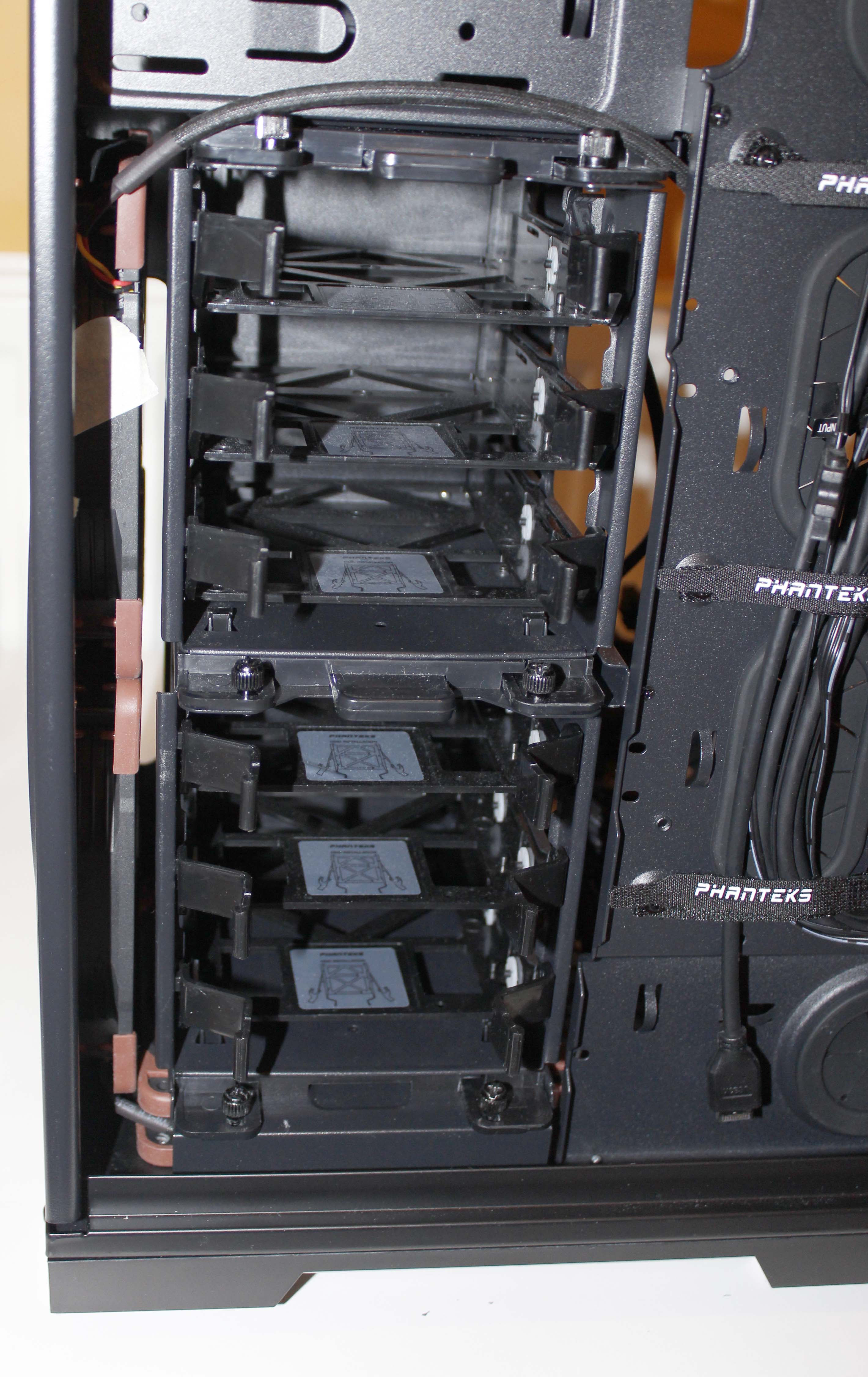

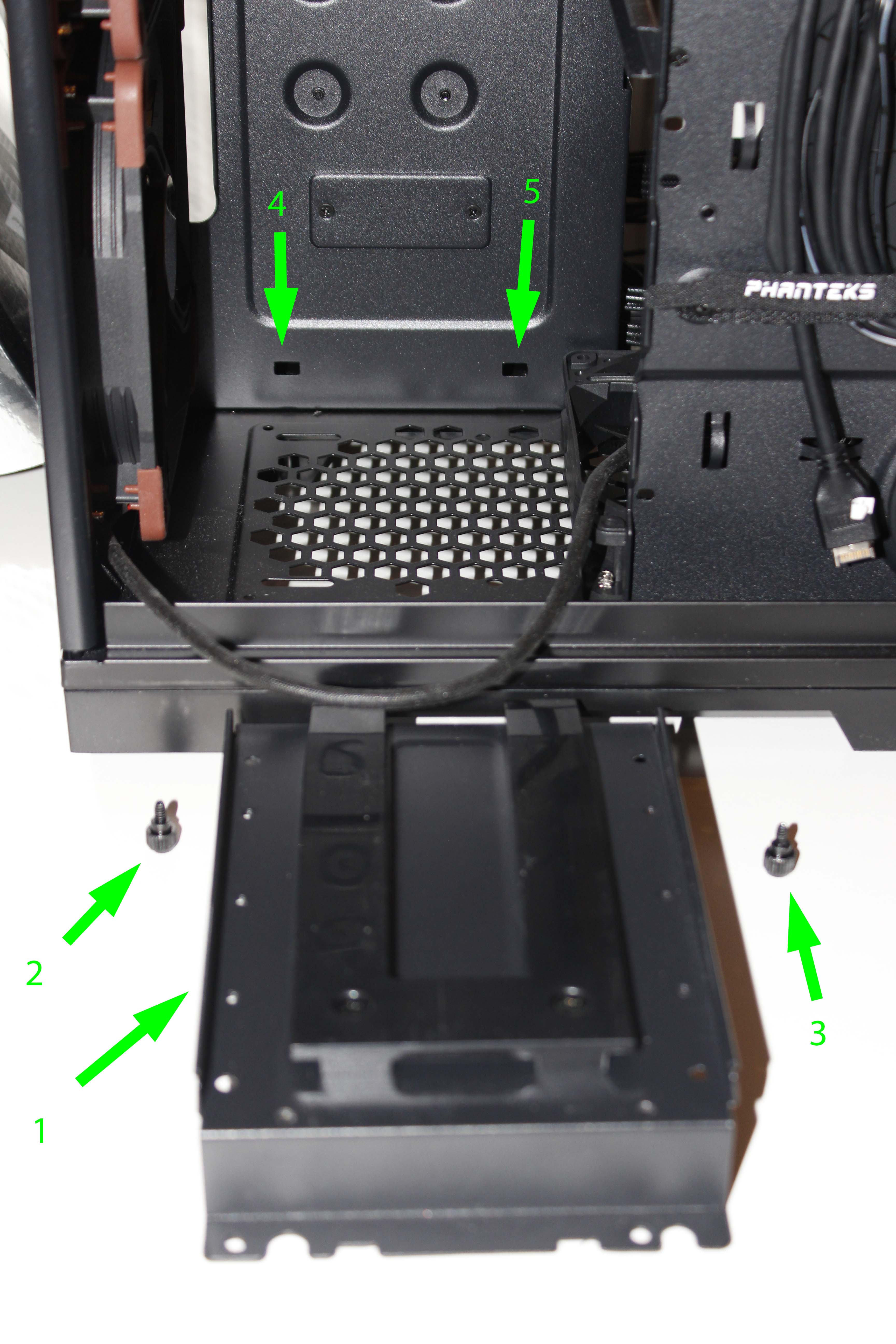

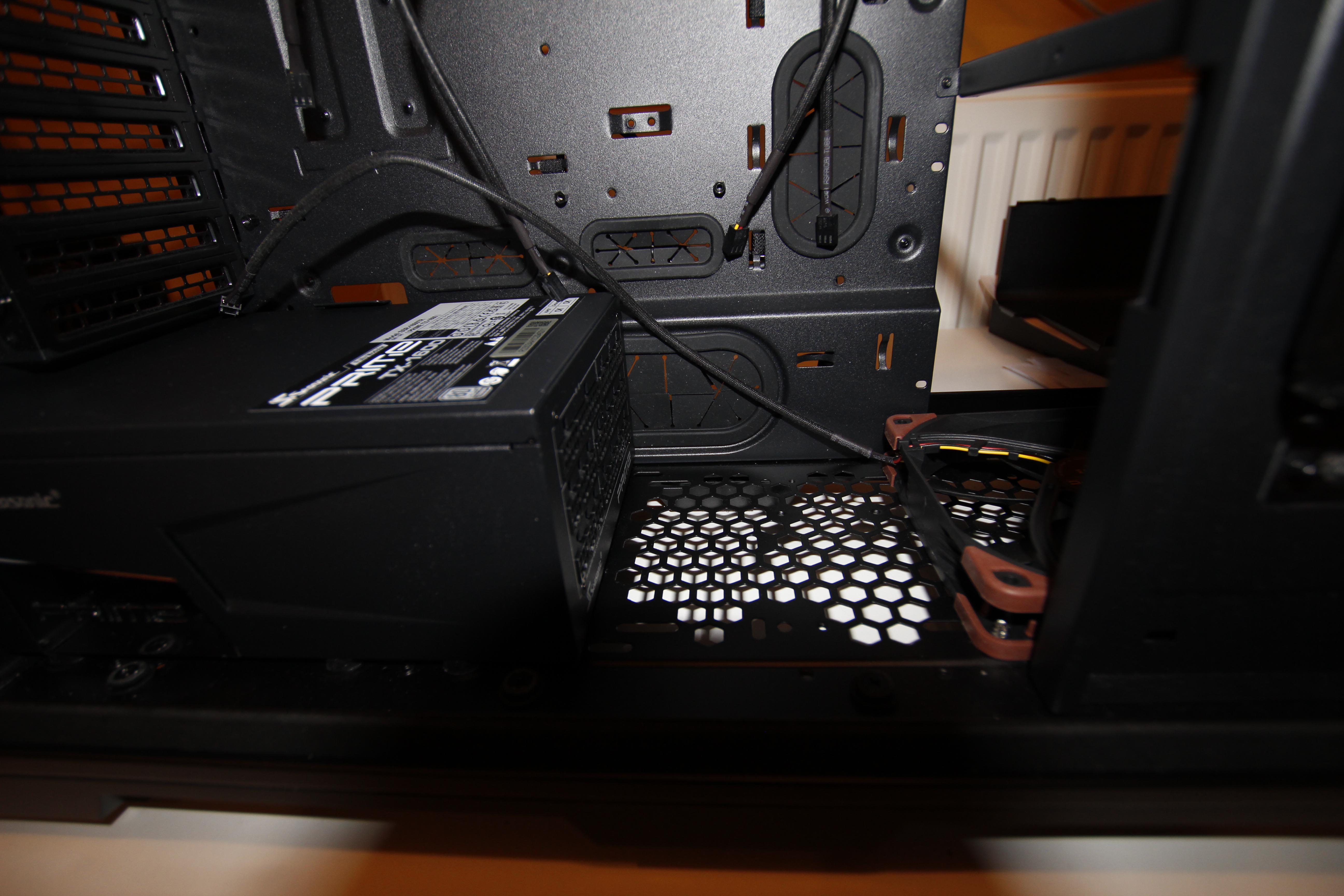

I think you are able to easily use all PSU power sockets while also keeping the bottom intake fan. But that requires for you to mount the fan under HDD cage.

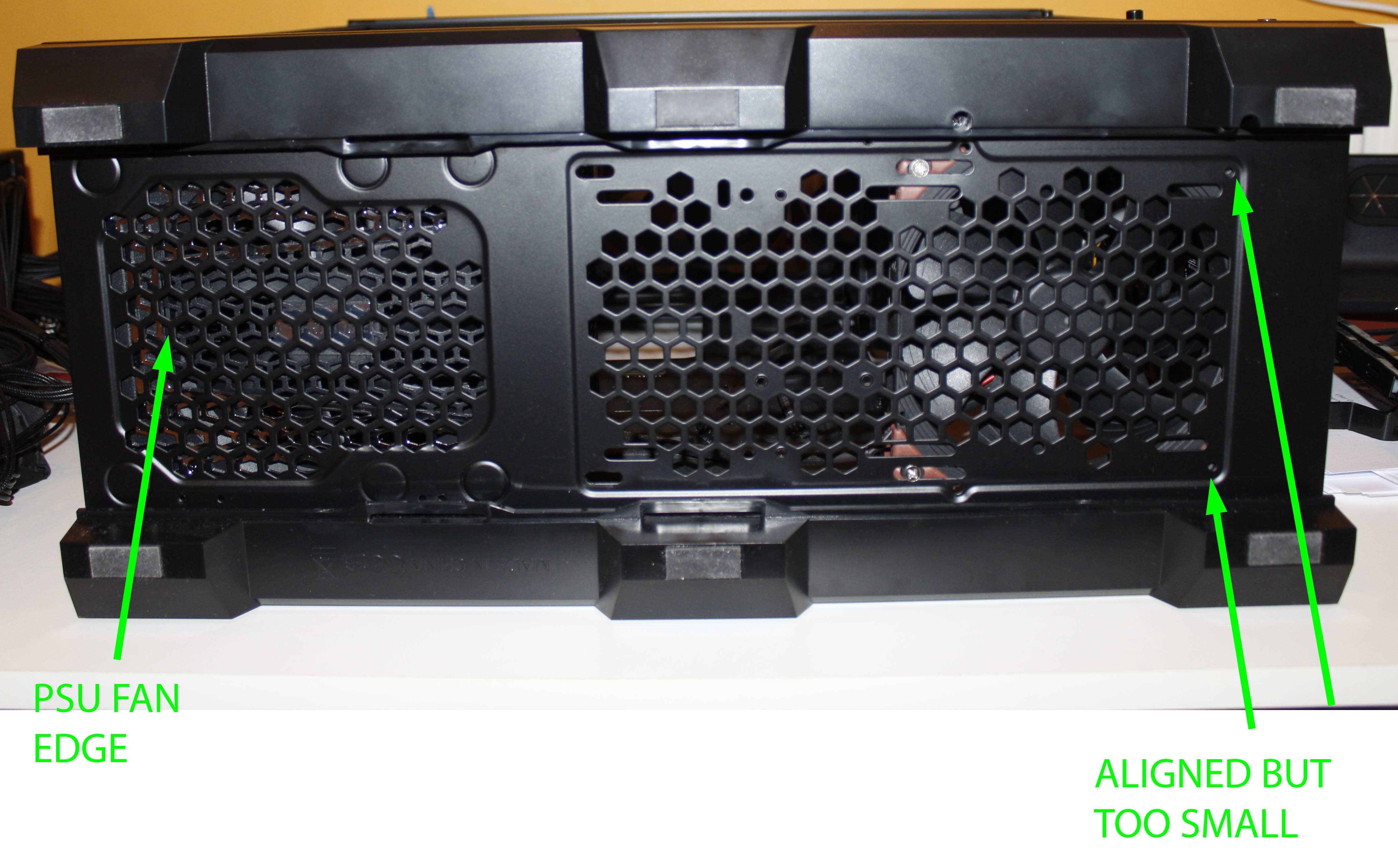

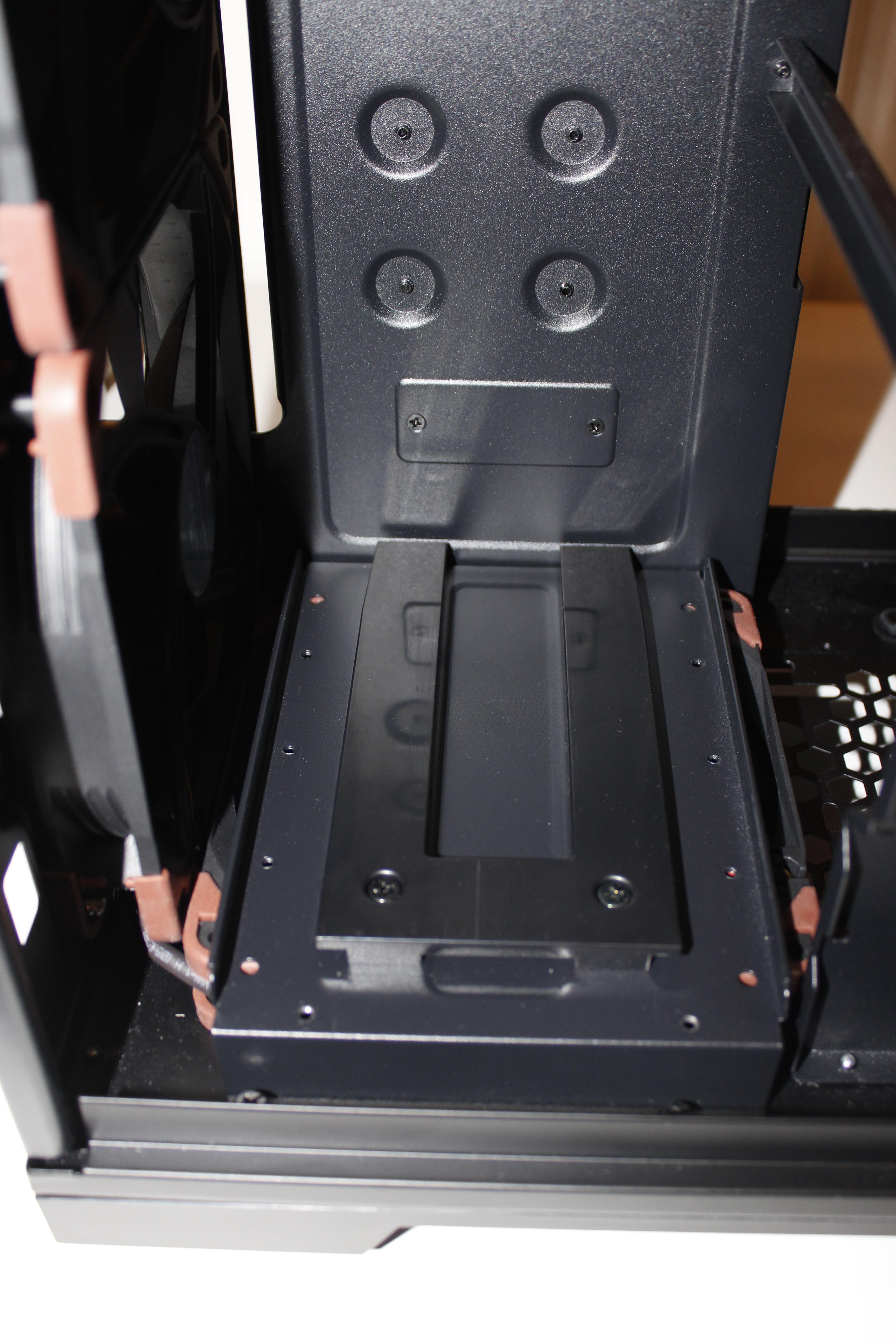

Now, i studied your pics and you can move the fan further under HDD cage but since at the very end, there are no 140mm screw slits, only 120mm ones, you'd end up fastening the fan with 2 screws.
Some image editing;
Legend:
Blue - fan frame
Red - screw mounting positions
Yellow - possible screw mounting holes for 140mm fan (can't tell quite accurately from the pic)
So, give it a look and maybe you can install the fan under HDD cage fully. This will leave ample space for PSU and it's cable connections.
As of silicone corner pieces, these aren't required per se. Noctua has added them to dampen the vibrations fan may cause (e.g resonates with PC case). But to get rid of resonation, loosen the fan screws a bit. Also, since PC would live in another room than you, the vibration noise wouldn't be an issue for you, IF there is even any.

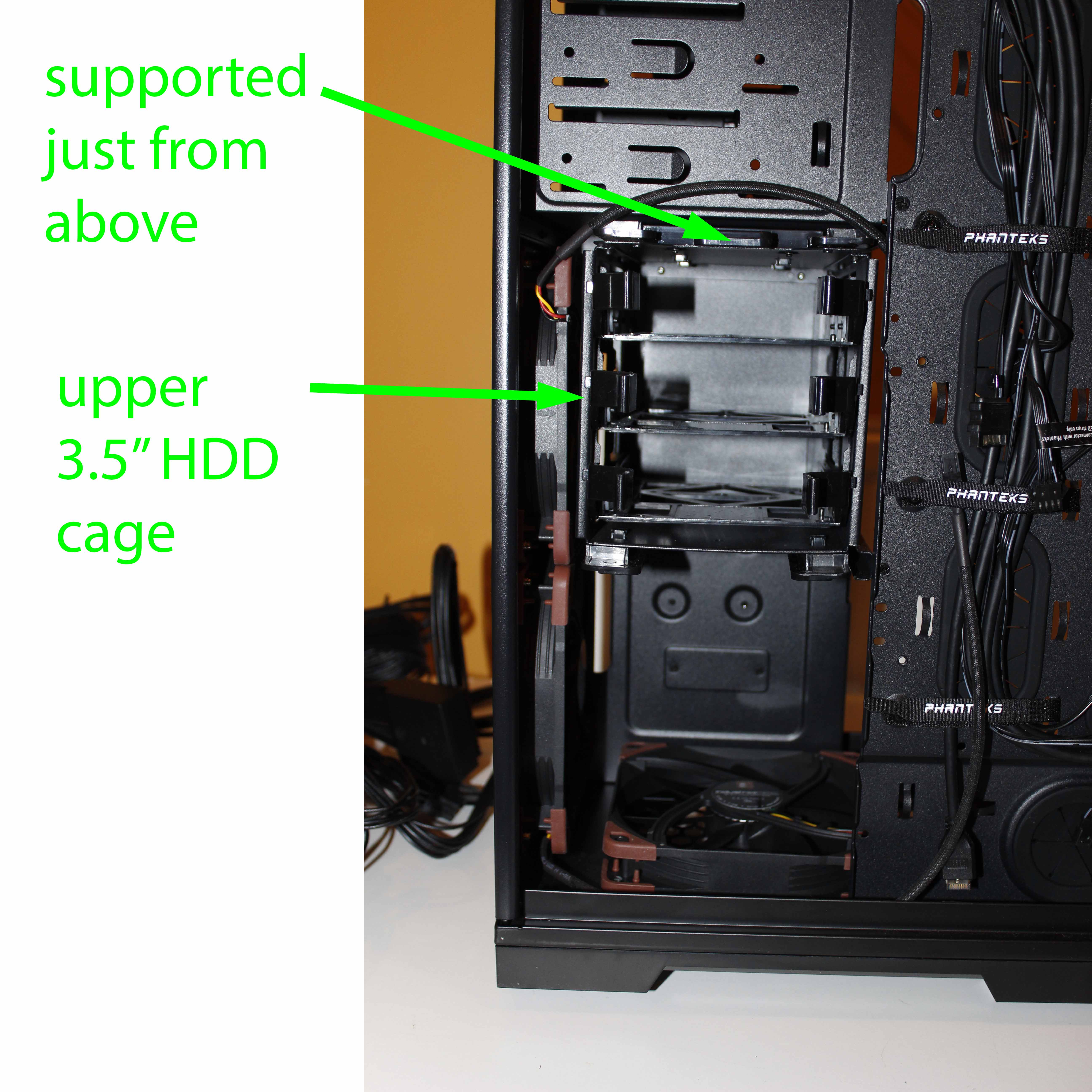

are you saying without temporarily removing the HDD cage?
and then also to remove the silicon corners?
if the HDD cage is to be temporarily removed, how is that done? I think some of the attachment screws must be hidden, where I will have to move some other stuff, but can I be sure that is removable?
Some image editing;
Legend:
Blue - fan frame

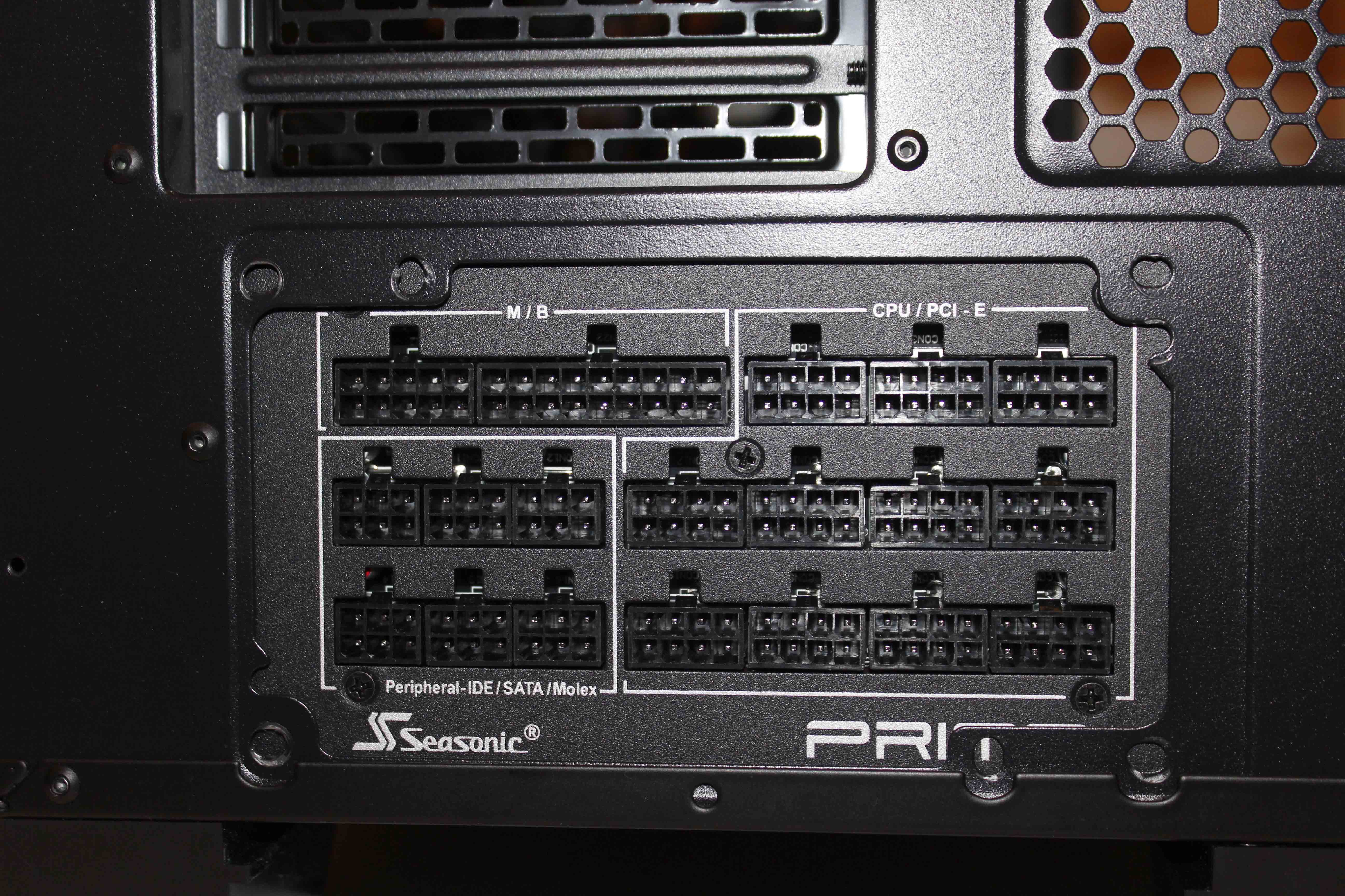

if the PSU could jut out a bit, that would resolve the problem nicely, but the tower back plate obstructs that idea!
the only other idea would be to keep the PSU outside the tower!
resonance could be a problem, where the entire tower starts vibrating subtly.
I would prefer to keep all supplied functionality, ie to have my cake and eat it!
ie use all PSU sockets, and keep all 8 silicone corners of the fan.
what I may do is initially not use the lowest row of power sockets, then if and when I run out of sockets to try to shunt the fan under the HDD cage. that way I can initially have my cake and eat it!

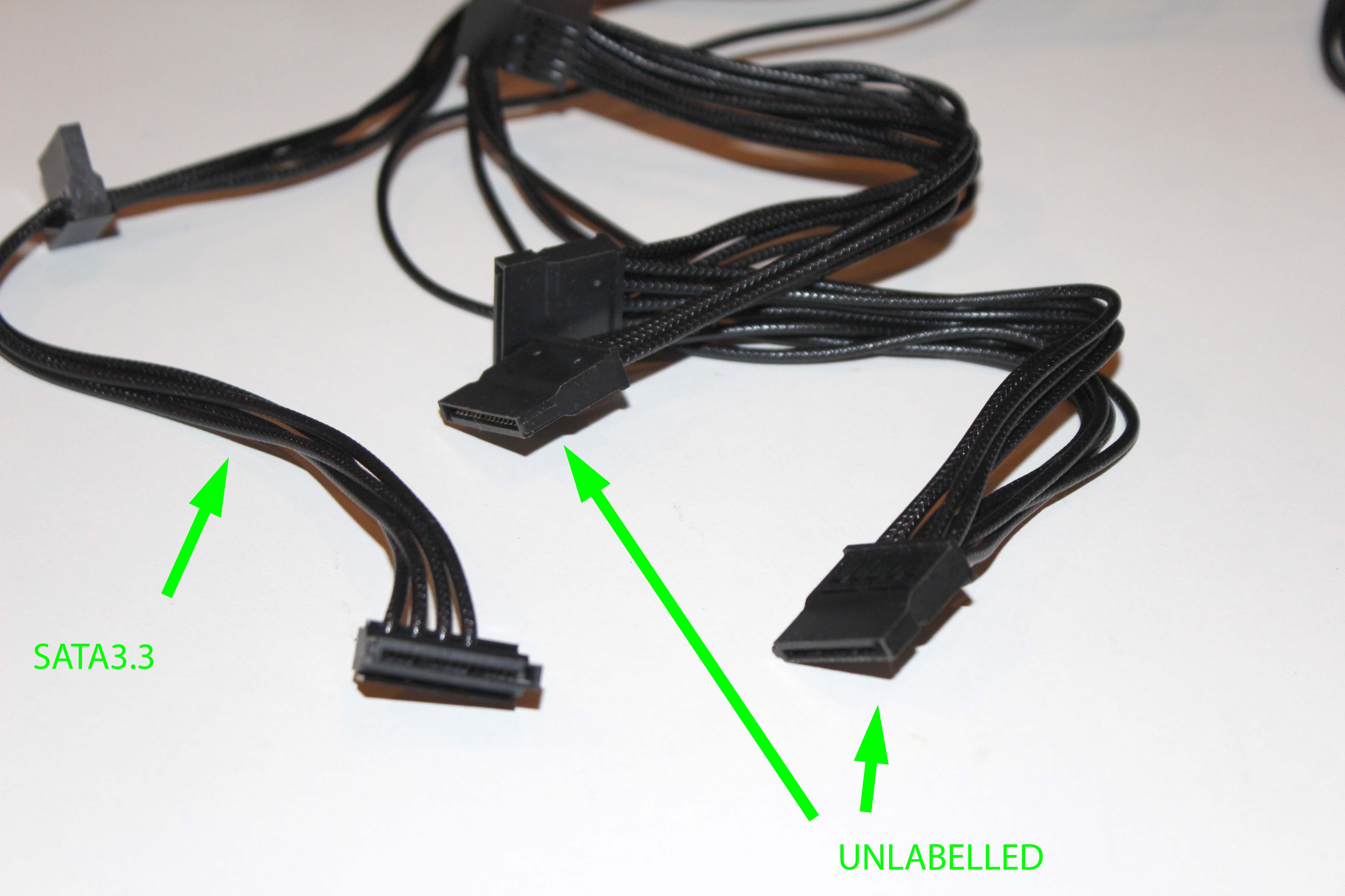

here is some ascii art of the socket arrangement:
_________________________________ / \ | = = = = = | | * mobo power ** **** **** **** | | ***** ********* **** **** **** | | = = = | = = = = | | *** *** *** | **** **** **** **** | | *** *** *** | **** **** **** **** | | = = = | = = = = | | *** *** *** | **** **** **** **** | <-- potentially | *** *** *** | **** **** **** **** | unused row | 3x2 sockets 4x2 sockets | of sockets \_________________________________/ = denotes detachment lever socket
if I dont use the lowest row, I have available 3 lots of 3x2 sockets, and 7 lots of 4x2's
with the lowest row, the leftmost 3x2 and the rightmost 4x2 are the most obstructed because of the silicon corners of the fan. the upper corners can be removed without affecting resonance mitigation,
ie I have a first tier of unproblematic 3 x [3x2] + 7 x[4x2] sockets
then a 2nd more problematic tier of 2 x[3x2] + 3 x [4x2] sockets
and then a final most problematic 3rd tier of 1 x[3x2] + 1 x [4x2] sockets
how many sockets do I need for the system as described in the original posting?
in addition, I have maybe 2 or 3 SATA SDD drives and a SATA bluray writer drive, and that is more or less all the hardware. other hardware is via USB which is an unrelated problem eg an A3 scanner via USB2, a 35mm film scanner via USB2 which is normally stored away when not used.
I may shunt the data on the SATA SDD's to one new SDD, as SATA drives are much cheaper now than when I bought them, in that era 250Gig was the max affordable price, I bought 500Gig drives only for technical reasons, to clone a magnetic 250Gig system drive to and ensure it fitted as different 250Gig drives are in fact different sizes, they are just approx 250Gig. today they are more or less giving these away for free in cornflakes boxes!

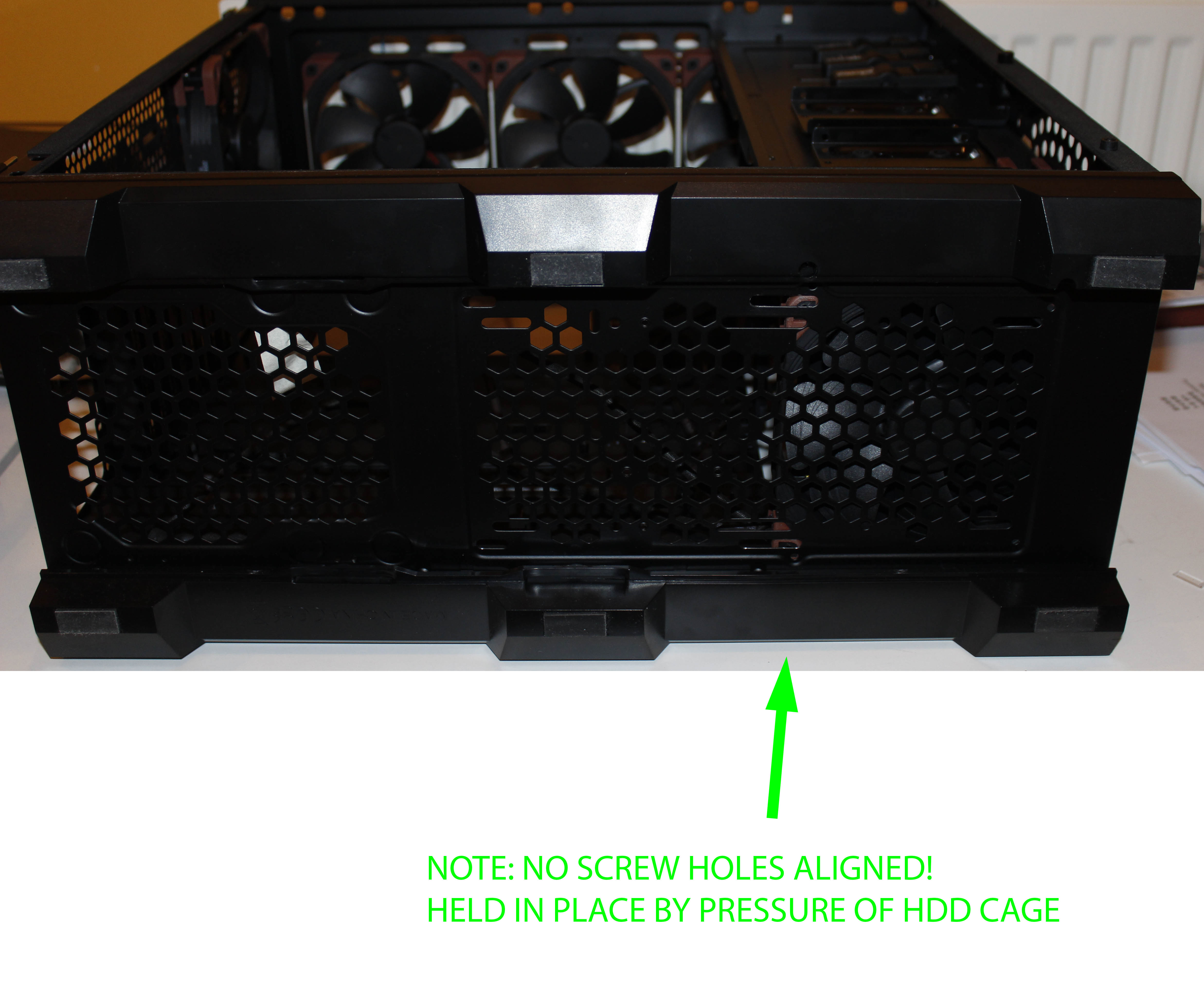

would it be any use to use just one 120mm fan for the base of the tower? or does that defeat the objective of making the machine quieter? where the other 6 are all 140mm
the thing is I want to see if it can be made quiet enough where I can use it in the same room!
currently the 2010 PC is not in the same room because it makes continual sound which I cannot work with, but it was much worse when I had magnetic drives.

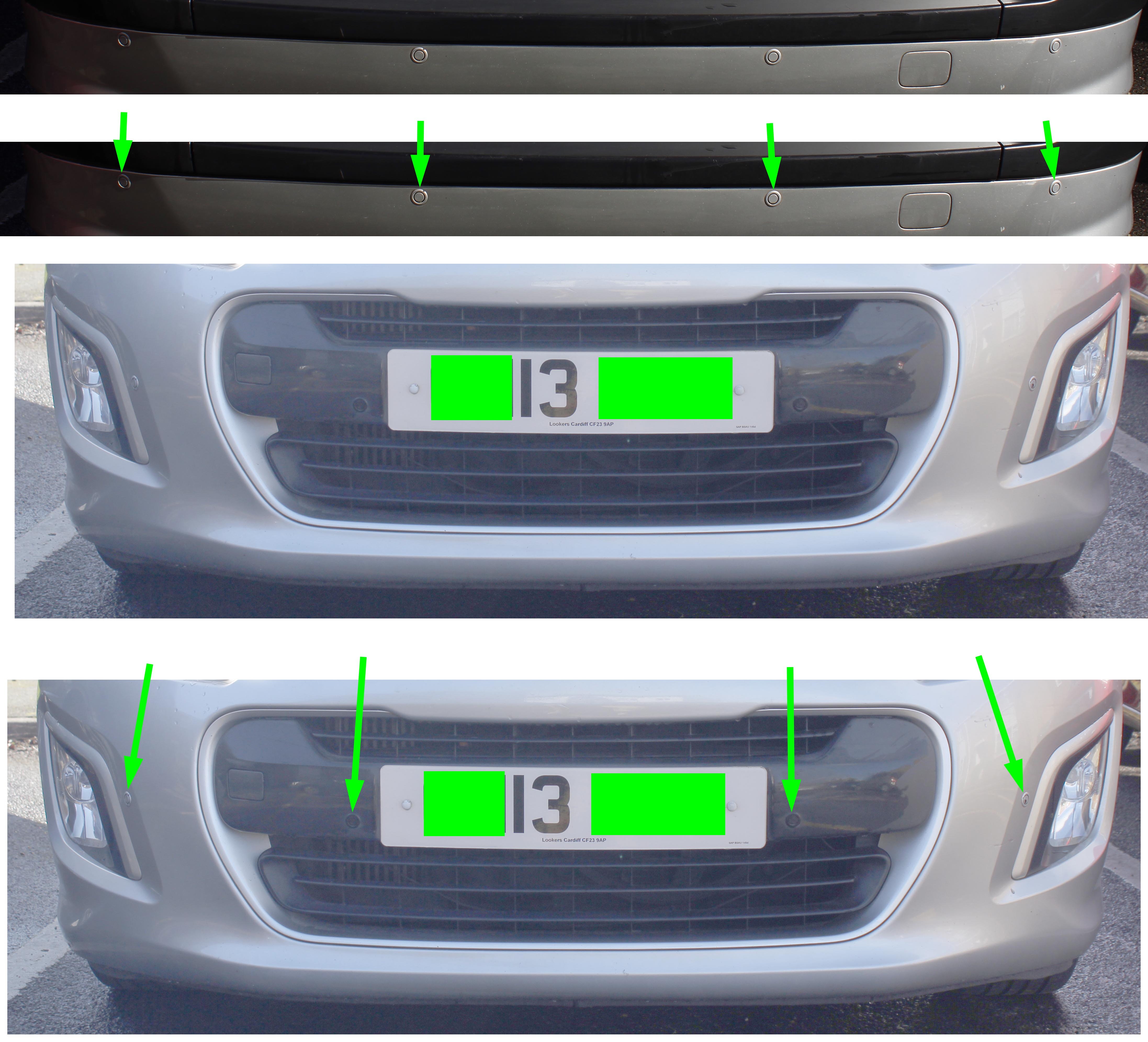

My car also has rear parking sensor, that beeps when i reverse. The closer i get to the rear object, the faster it starts to beep, while producing constant noise when distance is 30cm or less. Helps in reverse parking but it also has it's flaws. The object must be in sensor range and not higher (e.g some low hanging branch) and it can't make sense of individual pole.
my car when manufactured didnt have them, but the garage installed them at the front and back.
they also could instal a camera, but they talked me out of that, but I might get one at some point!
the back ones only and always come on when you go into reverse, where the constant noise means still enough space but you should halt.
the front ones need a switch to activate them, when they will continue even after you switch off the engine, which can drain the battery.
I havent tested the up down sensitivity, but they deal with proper road structures eg bollards and other cars and walls.
in terms of sensing an individual pole, it may depend on how many sensors are installed or the thickness of the object. I havent tested say whether it will detect a broomstick.
mine are 3rd party ones, and the garage were more adept, the official peugeot dealer couldnt do these things, but this small garage could!

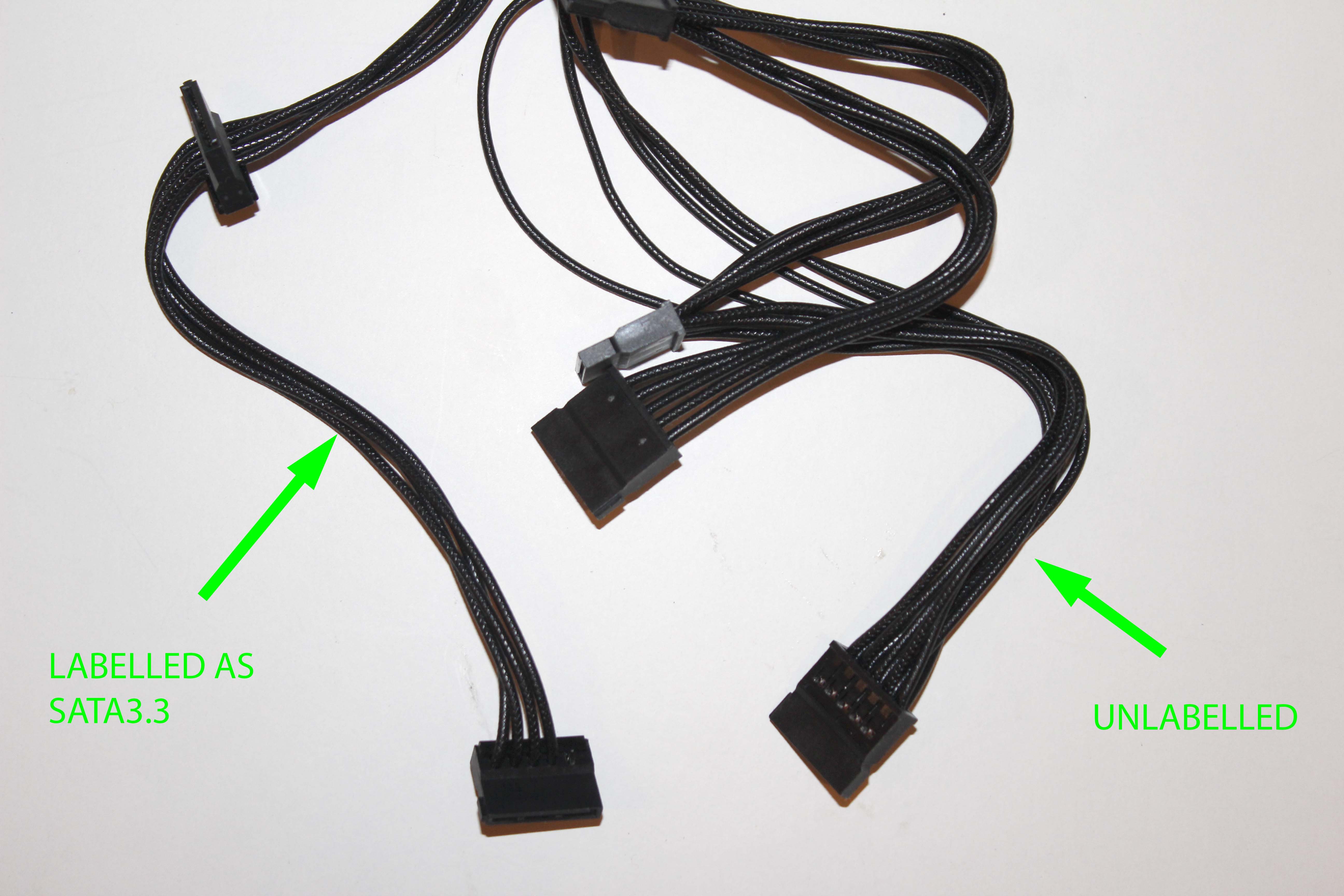

with the PSU, there is some confusion as regards SATA cables, it has one cable which says SATA 3.3 on it, and then a whole load of what look like SATA cables, with 4 sockets per cable, but no label.
2 photos which are in fact the identical objects, photographed from 2 different perspectives:
http://www.directemails.info/tom/psu/sata_cables1.jpg
http://www.directemails.info/tom/psu/sata_cables2.jpg
the manual is almost nonexistent, it certainly doesnt discuss the supplied cables.

success! although I need to check a technicality, see later for the question.
I have spent hours on this, total nightmare, repeatedly installing then realising one or another problem and then uninstalling,
I finally did an installation, which was ok in some respects, then I revisited this picture:
This.
Some image editing;
Legend:
Blue - fan frame
I decided maybe this was the thing to do, then realised that the screw holes are a problem.
then I had a major brainwave: doesnt need any screws! but can be pressed in place by the HDD cage, AND to try and keep all 8 silicon corner covers. No guarantee this would work, but it did, AND major work to do this.
I wont document the failed ideas, even though those led to the eventual MO which works.

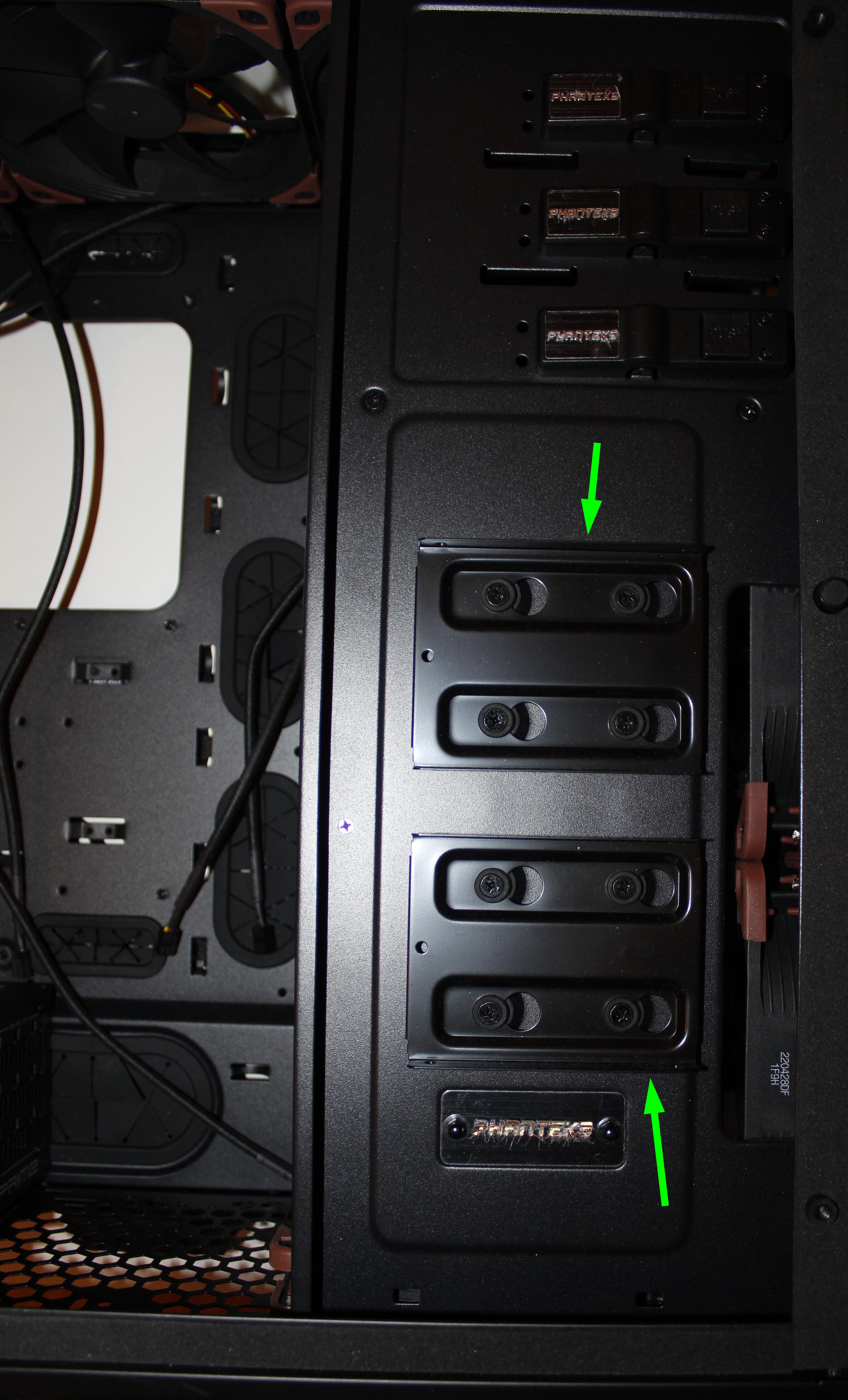

first thing is to remove the HDD cages, but then to also remove the base which is held in place by 2 thumbscrews at the outer edge, and metal slots at the back, see this photo:
http://www.directemails.info/tom/psu/hdd_cage_totally_removed.jpg
with this photo, (1) is the cover of the base, at the front it is held in place by the 2 thumbscrews (2) and (3), and it slots in at the back at (4) and (5). these 5 items are where some nightmares happen!
what I had to do requires a very specific install sequence, which I learnt by repeatedly trying other sequences and then running into snags, eventually arriving at an MO that works.
it goes like this:
fully remove the 2 front fans, on the left edge of that photo.
then to place the base fan under the base cover (1), and try to partially put the base in place clamping down the fan but not properly attached yet.
then to move the lower front fan on the left edge of the photo in place, and run its power cable along the front edge of the base fan UNDER the base cover (1).
one has to turn the case around to look at (4) and (5) from the other side to try and align the metal plugs of the base cover with the slots (4) and (5).
now there is a problem with the thumbscrews that they dont stick to the screwdriver, and have a tendency to vanish under the front edge of the tower. eventually I remedied this by attaching the thumbscrew to the screwdriver with masking tape (easily removed tape used for painting things, to cover bits that shouldnt get painted such as hinges).
with the right thumbscrew taped to the screwdriver end, I then pushed the plate towards (5) and screwed in that edge, this is a bit of a performance.
then once the screw takes, to remove the masking tape and continue attaching that screw.
then same performance with the left thumbscrew.
now to slide in the lower front fan on the left edge of the photo.
then to attach the upper front fan.
where what we have now looks like this:

a photo of what this looks like is this:
http://www.directemails.info/tom/psu/impossible2.jpg
annotated to show that there is total misalignment of the screw holes.
to get alignment causes all kinds of other problems.
this way the fan is shielded from the tower case by 4 silicon supports, and shielded from the HDD cage by 4 silicon supports, which should nullify any resonance vibrations.

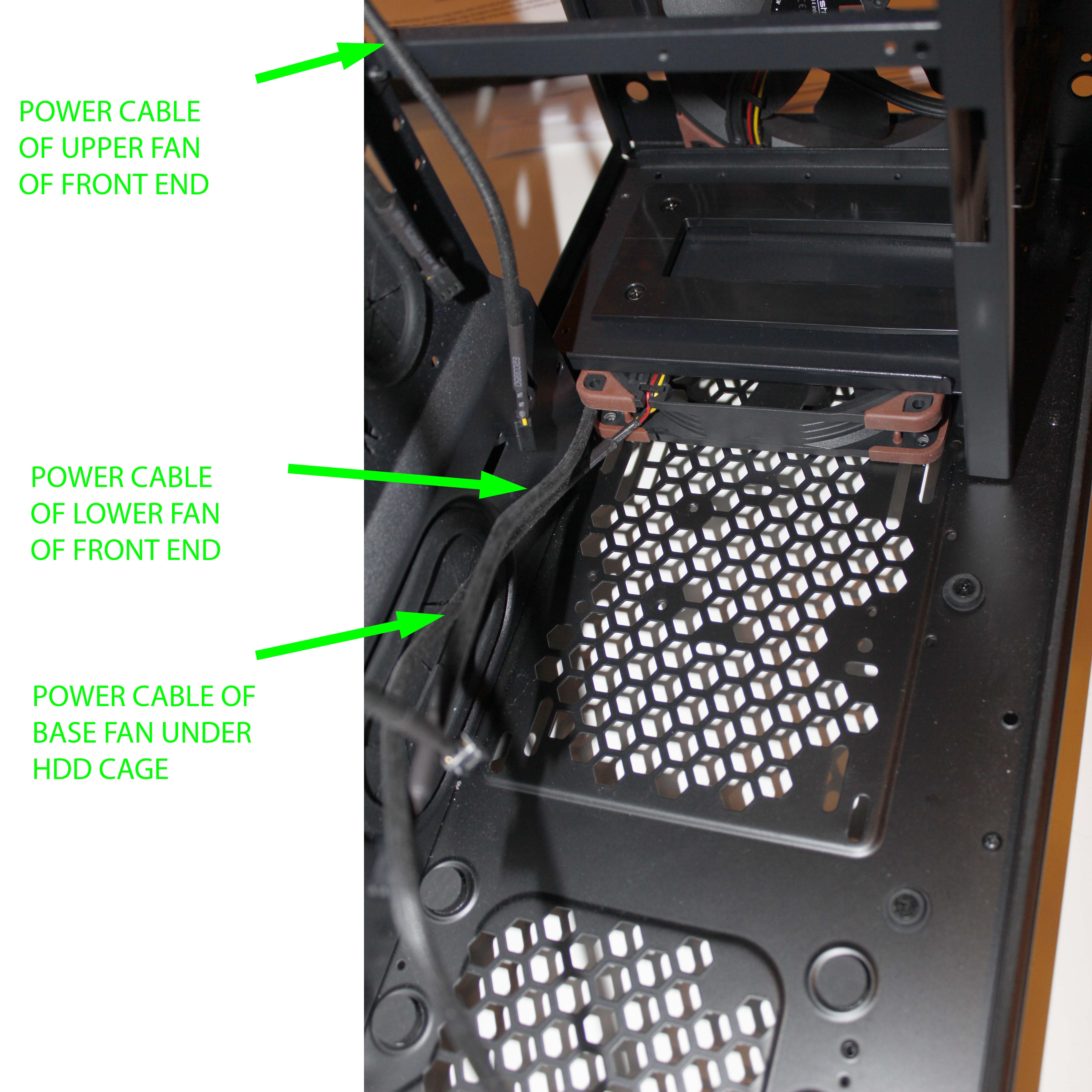

a photo from inside the case looks like this:
http://www.directemails.info/tom/psu/impossible3.jpg
where I have annotated where the 3 fan cables run, and you can see the future PSU side of the fan's 4 silicon corners are all in place.
with the PSU then installed, the back cover looks like this:
http://www.directemails.info/tom/psu/impossible4.jpg

reinstalling the HDD cage was very tricky, because the fan underneath bulges the HDD cage upwards, and it requires force to align the screw holes for the HDD cage thumbscrews, namely the upper 2 and the lower 2.
the HDD cage reinstalled looks like this:

the installed PSU inside the tower looks like this, where now plenty of space:
http://www.directemails.info/tom/psu/impossible6.jpg
the aforementioned question is whether there is enough air channel above the fan with the HDD cage clamped so tightly?
as explained above, I have now done this, but I needed to abandon the idea of attaching with screws, I then had much more liberty, but the HDD cage needs to rest on 4 silicon corners to get full damping.
I have now managed it with all 8 silicon corners in place, and the main question is whether there is enough gangway ABOVE the fan for the airflow?
it was a mistake to install the front fans before the base fan, its best to start with none of the 3 fans, namely 2 front fans and base fan, and to remove the HDD cage fully, and remove the base cover (1),
then to place the base cover covering the base fan and try to get this right, which is a major performance, where its best to look at the tower from the other side, as the only way to align the metal plugs of the base cover with the slots (4) and (5), the metal plugs are below the top surface, so cannot be seen from the front.
and even when you see the metal plugs from the other side, the work isnt done, the base cover has to be pushed with some force at the same time because the fan pushes back the cover from being pushed in place, as screwing in a thumbscrew which also must be taped to the screwdriver as not magnetised. if you dont, the screw will drop out and get stuck under the front edge of the tower case!
ALSO reinstalling the HDD cage above the base, is more problematic than when no fan under the cage, as the base bulges out because of the resistance of the fan which makes the thumbscrew holes no longer align, and this requires major force to align them whilst at the same time screwing in the thumbscrews.
further important point: its not viable to slide the fan under the installed HDD cage, especially if you want to keep all 8 silicon corners. the only way is to place the fan under the base (1) and to attach the base with the fan already under it, not viable to slide it under afterwards.
and positioning the fan is a total nightmare if you wish to screw it in, and all screwpoints are unsatisfactory, impossible to get more than 2 screwpoints, and these will always be at the 2 slots marked with the red circle in the photo. impossible to attach at all on the right, eg the holes marked in yellow are too small a radius!
but if you just clamp the fan in place, then you can somehow wing it to something that works, where the only constraint is all 4 upper silicon corners are sat on by the base cover (1). you then get optimal damping.
This is something i actually did not consider. :unsure:
Since HDD cage base plate is solid metal, it will effectively block off all the airflow from the bottom intake fan. Also, if the HDD cage base plate is essentially resting ontop of silicone fan corners, it would leave, what... 1-2mm space between the fan frame and HDD cage base plate? This is way too little.
Now, if the HDD cage base plate would have holes in it, preferably grille, it would let the air pass through it and it wouldn't be an issue.
With this, there are 3 options:
1. Drill holes into that metal HDD cage base plate, so that some air can pass through it and won't be completely blocked off (don't drill holes into plastic part of it, since that plastic frame is needed to hold HDD cages in place).
2. Move the fan towards PSU, so, at least 50% of the fan would be unobstructed by HDD cage base plate (preferably the less obstruction - the better).
3. Don't use bottom intake fan at all.
4th option would be mounting the 140mm fan close to PSU, but since that will block off entire row of PSU connectors - this is not a valid solution.
All 3 options have drawbacks;
#1 Unsure how willing you are drilling holes into HDD cage base plate. And can't drill holes too close to each other as well, since you'd be weakening the structural integrity of the HDD cage base plate, whereby it would end up too weak to hold up the HDD cages and drives in it.
#2 Perhaps the least bad option. But depending on how close you move the fan to a PSU, you may run into blocking off 3rd row of PSU connectors.
#3 Removing one of the three intake fans will move your build airflow to negative pressure. Even when you run the two front intake fans at full tilt (2000 RPM), while keeping the 4x exhaust fans at ~1000 RPM, you'd still have negative pressure since CPU cooler also acts as exhaust. Now, on cooling aspect, negative pressure is good, but you just need to be mindful about dust and perhaps clean PC internals a bit more often than with neutral/positive pressure.
Tricky situation. :unsure:
Personally, i'd do the #2 option, since it would be the best compromise. Downside is that when you move the fan 1/2 (half-way) or 3/4 towards PSU, you can't use screws to fasten the fan since screw slits won't align with fan screw holes. Whereby HDD cage base plate would hold the fan down from two corners. But at least it would give you bottom intake and most of the fan won't be blocked off by HDD cage base plate either.
Let's see;
1x 24-pin ATX for MoBo, uses up both M/B connectors on top row of your PSU.
2x 4/8-pin EPS for CPU, uses up two 8-pin (2x4) CPU/PCI-E connectors on PSU.
1x 12VHPWR for GPU, uses up one 16-pin 12VHPWR connector on PSU. (One in middle row, one in bottom row.)
Optional:
1x 6-pin PCI-E to power USB port for 60W for fast charging (PD_PWR1 connector on MoBo, description on page 46), uses one 8-pin (2x4) CPU/PCI-E connector.
1x SATA to power up to 4x 2.5" SSD/3.5" HDDs, uses one 6-pin IDE/SATA/MOLEX connector.
Depending on how many 2.5" SSD/3.5" HDDs you plan to power, SATA power cable count can go up, but one cable can power up to 4 drives (since it has 4 connectors).
SATA 3.3 cable is the power cable where there is no +3.3V rail in the cable. It only has +12V and +5V rails.
These 4 connectors per cable are standard SATA power cables. While having all three power rails: +12V, +5V and +3.3V.
Mine are factory default and i have 2 sensors on the back bumper.

what is the HDD cage for in practice?
is it just for old era magnetic hard disks?
the inner width of the trays looks like 4"
what I can do is just remove the base plate and the entire HDD cage, which then creates major airspace above the base fan and the lower front fan, although there is the problem of how to hold the base fan in place: I can hold it in place with the 2 screws on the PSU side, and nothing on the other side, but maybe I can loop some wires.
the HDD cages in fact can be held in place from the upper support as there are support rails at the top and thumbscrews at the top. this should support the weight, but you can move the cages left and right somewhat. I dont know if the air current would rock the cages?
the lower cage attaches to the upper cage via further rails. thus if both cages are attached without base plate, the lowest one will rock a bigger distance.
The SDD supports are unaffected as they are on a backplate independent of the HDD cages.

maybe those wider bays at the front are more useful, eg my 3D bluray writer looks like 5.75" width.
I have to think about the various options, it is something to think over before doing anything, to avoid redoing something I did earlier.
unless I foresake the lowest row until the day that I need some!
similarly to foresake the HDD cages until that day when I need some.
could I use splitters of the upper rows instead of the lowest row, or is that inadvisable?
not keen on the idea of the work! but maybe I can find some company to do it for me,
the structural integrity isnt a problem in terms of supporting as the base plate is strong metal, where the support is in fact via the plastic rails, so a huge zone could be cut out, eg a big inner rectangle could be removed.
in fact you can support both cages from the top rails and thumbscrews with the entire base plate removed!
but the cages will rock left to right, I cannot gauge that right now as I have to remove the base plate to do that, but I can gauge if just the upper cage is there,
I did try this when the base plate was removed, and no problem supporting a fair weight from the top rails.
the base plate is only necessary to prevent left right rocking.
now if I were to cut it, the question is what equipment?
alternatively I could try to find some workshop to do it for me,
I am sure when driving in recent weeks I saw a firm which said they do metalwork, but can I remember where I saw that!
I keep notes of every car journey I do, so I can check that to think which journey it might have been!
but I want to first consider options which dont involve irreversible modifications!
eg the removal of the entire base plate and HDD cages, and also if I just dont use the lowest row of PSU sockets,
eg if I opt out of the lowest row of PSU sockets, I can then keep the HDD cages as intended by Phantek.
it is in the shortlist of reversible options!
hacksawing the tower case is irreversible!
I could also hacksaw the backplate cover of the tower for the PSU, and make the PSU jut out some cm.
120mm bottom intake fan can actually work, and well as well. E.g both of my builds (Skylake and Haswell) have 120mm fan as bottom intake since neither of the PC cases i have support 140mm fan as bottom intake, only 120mm fan.
what is the best 120mm fan then to conform with the original plan of minimal noise and heat in the earlier topic?
where your idea was that several 140mm Noctua fans could deal with ordinary usage at a lower rpm, where the total noise much lower than other options, based on counting decibels. each doubling is 1 decibel, so I think 2 machines at 90decibels is 91decibels, and 4 machines would be 92 decibels. so even 1 decibel lower is a major improvement.
is there a Noctua one to go for? or is some other firm more optimal for 120mm?
disregard price initially,
the other thing is whether the screw holes locations for a 120mm one will be problematic.
the only option is the slots and the larger holes, at least for the 140mm Noctua's screws, these wont fit in the smaller holes, and the large hexagonal holes are too big.
measuring the distance between the centres of the installed screws, the 140mm Noctua's screw holes appear to be 12.5cm apart, how far apart are the 120mm Noctua ones?
my guess is 12.5cm - (14cm-12cm) = 10.5cm, but I need the actual distance!
are the 120mm Noctua screws identical to the 140mm Noctua's?
more generally are fan screws all the same standard?

Let's see;
when you say "one in middle row, one in bottom row", do you mean "or" or "and"?
are you saying the 16 pin can be done via the middle row, or alternatively by the bottom row,
or are you saying it will use up both rows, eg one socket in the middle row and maybe the socket under that in the bottom row?
and why cant it be used by the top row, or is that the CPU one?
at the moment probably 2 external SSDs, so that would just use one
could there be a problem also of distances? as those SATA power sockets are kind of daisy chained, you'd need successive SATA devices not too far apart.
is that a coincidence that SATA 3.3 cannot do 3.3 volts?
what can I not do with this SATA cable?
what precisely is the point of a SATA cable which does less voltages and has less sockets?
aha, that could be part of the problem, looking at cars the other day, some have 4 sensors, but that could be at the front.
if you just have 2, there could be problems if an object is at the furthest distance from any.
you need to find a garage who can maybe fit custom ones. you need to declare all modifications on your insurance form, that way if you make a claim, the insurance company have to reinstate the modifications also!
I'll check later how many were fitted by the garage for my car.
To house 3.5" HDDs. 3x per cage and since you have two cages, then 6x in total. Same space can be used to house 2.5" SSDs as well. Again, 3 per cage and 6 in total.
If you'd run your fans at full tilt - maybe. But if you have 3.5" HDDs populating the HDD cages, it adds weight to them and it would be unlikely.
But if you don't need to use HDD cages to house 3.5" HDDs or 2.5" SSDs in them, then you can remove one or both HDD cages, giving your bottom intake fan good clearance in terms of airflow. Front intake fans would benefit from it as well.
NEVER use any power cable splitters. Only use those power cables that came with the PSU. Else-ways, you can end up overloading the power cable that can (and most likely will) lead to cable melting, short circuit and catching fire.
I guess you don't have power drill with drill bit to drill holes into metal, at home? (I have, bought complete set when moved to new home, since you'll never know when you may need it. And i've needed my Makita battery powered power drill since then quite a bit. I have a complete set of concrete, metal and wood drill bits, in varying sizes.)
Overall, it is easy to do. Locate any metalworker and describe your issue to them. It is easy to fasten the metal plate to a bench vice, take out the drill and drill some holes into it. Far better than trying to cut out a section, since depending on method, either welding or angle grinder can be used. Also, no point to cut out a piece from dead center, since under that would be the fan motor hub, with little to 0 airflow. Instead, you'd want holes where the fan blades are, and not in the dead center of that plate.
How to drill into metal:
View: https://www.youtube.com/watch?v=yjEE8EAHOxo
I advise against that since installed PSU helps to increase PC case structural integrity. Also, when you'd slide the PSU out a bit, have you considered that the PSU cooling fan also moves outwards, whereby you could be partially blocking off the PSU fan (since you've mounted the PSU fan facing downwards)?
Yes.
There are two 16-pin sockets on your PSU. It doesn't matter at all which of the two you use, to power your GPU.
Here's the pic of your PSU connectors, oriented in the way as you've installed the PSU in the PC case;
(Gives better visual over PSU connectors than your ASCII art. :) )
As you can see, 16-pin connectors are located in the middle row and on the bottom row. Upper row contains MoBo 24-pin cable sockets and 3x CPU/PCI-E slots.
3.3V rail in SATA cable is more like lingering and obsolete feature.
3.5" HDDs need 12V and 5V to operate while 2.5" SSDs/HDDs operate at 5V.
3.3V drives are now almost unheard of. Some old SATA 1 drives may use 3.3V for operation.
there appear to be 2 kinds of wires, those on the right which look like temperature probes,
and then a different kind of cable on the left, which I cannot identify.
Bundle of cables on the right are temperature probes. In the middle, there is MOLEX cable for power and bundle of cables on the left are channel cables to be connected to a fan.
what are the 2 lengths? and can these wires be extended or replaced by longer ones?
eg are the temperature probes standard or are they proprietory for this manufacturer?
I have 0 clue what the cable lengths are since i didn't measure them when i installed the fan controller. And i can't measure them now either, since i have the fan controller installed with proper cable management inside my PC.
Since all cables are socketed to the PCB of fan controller, you can replace them with longer ones. Fan cables (channel cables) should be standard ones. Same with temp probes, since one temp probe is just 2 wires. Only MOLEX connector to the PCB may have proprietary connector. But because i didn't take any of the connectors apart, i don't know exactly.

before the replies, I had a look at another idea which is to fit the fan outside the box, ie under the base rather than above, there could be 6mm of leeway, but the problem is the base filter cannot be installed as intended. only option would be to create some structure eg from wood with the base filter even lower,
I sent emails to Phanteks, Noctua and Seasonic about the problem. only Seasonic have replied so far, just forwarding me to the manual which doesnt talk about fans. I replied back saying this, and they sent a further email.
I give my interpretation of their emails which is that the Prime TX1600 is bigger than usual PSUs and in fact is their physically largest PSU, which will be the cause of these problems.
my interpretation is that one idea is I could place the PSU the other way round, and in fact the PSU socket panel then fits perfectly in the PSU panel zone at the back of the PC!
there are 2 snags with this gameplan,
1. there are no screw holes on the socket side of the PSU,
2. the output fan points into the tower,
see these 2 photos of putting the PSU pointing the other direction:
http://www.directemails.info/tom/psu/reversed_psu1.jpg
http://www.directemails.info/tom/psu/reversed_psu2.jpg
the further question then is the viability of sending the cables from the back of the PC.
maybe through one of the tower case's back panel's PCI slots?
I just think even the 2.5" SSDs are now obsolete. I have in any case I think 2 vertical SSD brackets on the side of the panel at the back of the HDD cage.
the 2T Samsung SSD USB3 drive I bought a year ago is much smaller. looks like 2 3/16 ", ie less than 2 1/4"
scrutinising the scenario, with the fan under the HDD cage zone and the cover plate removed, the 140mm fan can be attached by 2 screws at the PSU end.
I dont know how viable it is for the fan to be just attached along one edge like that?
in that case I could remove the HDD cage if unpopulated!
the only thing is the 2.5" SSDs arent heavy!
the old 3.5" ones are hulking contraptions, maybe I could use a defunct one as a stabilisation weight!
I may go for this path, main snag is the fan would be attached at 2 points rather than 4. I could attach a 120mm one at 4 points.
the thing is I dont have a bench, and no room for one! but I may be able to improvise something.
for the moment I will focus on reversible methodologies, metal cutting is the last chance saloon!
I didnt realise that, I just imagined the centre would be the max flow, but it does make sense that the fan linear velocity is faster the further out you go from the centre, and thus should be faster airflow.
ok, I had a watch of the full video, there is quite a lot of technique. if I hadnt watched that I would have just marked a spot and begun drilling directly!
scrutinising the fan in the PSU through the ventilation grid, I can jut the PSU out by 2cm before the fan gets obstructed!
but as that plan is irreversible, I will look at the reversible plans first.
reversible plans you can opt out later,
irreversible plans are opt in only!
your photo is wrong! the Seasonic Prime TX-1600 doesnt have those two 12VHPWR sockets, but instead has two further 4x2's there,
here is the correct photo, where I think you may need to reply on this part of the problem from scratch!
http://www.directemails.info/tom/psu/psu_sockets.jpg
there are 2 supplied 12VHPWR cables, with sockets that look like the 12VHPWR ones in your photo, but at the other end they are two 2 x 4 sockets, with the rightmost 2 x 1 pins unused for each,
this would enable the lowest row to be avoided for the two 12VHPWR's regardless whether the PSU is installed upside down or not.
its just for SATA 1?
I have never used such, but I imagine a low end SATA of today will be vastly bigger capacity than a top end SATA 1 drive, so you might as well just clone the data to a cheap drive today and abandon using the old drive.
I wasnt looking carefully, and thought the MOLEX was the same as the ones on the left!
are you able to source longer ones of both the fan cables and temperature probes on the internet?
I checked, and the garage installed ones are both 4 sensors, see this photo where I show the photo both annotated and unannotated. the 13 in the redacted number plate means the car was manufactured in 2013.
http://www.directemails.info/tom/psu/sensors.jpg
its possible if you get such custom ones, the sensors will become more sensitive.
because the guaranteed distance to an obstacle will be much shorter. if you just have 2, then the centre or the outer extremes might be too far especially for thinner objects.
what you want maybe is 6 of them!
I have looked at other cars in town, and some have none, some have 2, some have 4.
with some things, 3rd party is far better than the car manufacturer's supplied item. eg my car's satnav doesnt show various roundabouts that were built since it was installed, which would be 2013. I bought the car second hand in 2016.
and the peugeot inbuilt satnav cannot be updated!
there was one roundabout which eventually they replaced by a very complicated crossroads, with 3 lanes per direction for one of the roads. the Peugeot satnav will show the old roundabout!
when I mentioned this to someone, he said his dad just uses an external one, either a Tomtom or a Garmin. as if to say nobody uses the inbuilt ones! so I got one, and its great.
next example: after some years, I noticed in rain, the wipers werent cleaning all the windscreen in rain. I went to the authorised Peugeot dealer, and the guy said: oh, just go to Halfords, the peugeot ones are no good. so I went to Halfords, the guy asked my number plate, then by putting the number plate in some software, he told me the specific wipers to get, which were by Bosch, and absolutely perfect!
I am completely nonexpert on cars, the garage just said they can install back sensors, or front sensors, or cameras, advising against cameras, and I opted in. as it was my first car, way too complicated to research the matter as I'd have to drive to garages etc.
according to my notes from 2016, it was £160+VAT all inclusive labour + parts for the rear sensors, £170+VAT for the front sensors, and £250 + VAT for rear view cameras. VAT=20%. I am planning to return there to ask them to install the cameras!
now when I asked the huge authorised Peugeot dealer, they couldnt do such things!

ok, some further work:
after much thought, I decided to opt for removing the HDD cages, that way plenty of airflow.
I removed the base plate, it had slightly scratched one of the structural arms but not the propellor blades.
I attached the fan with 2 screws at the PSU side, and put some masking tape at 2 other edges to hold it to the base of the case. I also found I could align the other 2 screw holes with holes on the tower case base, but too small for the screws to fix. I temporarily put a straightened huge metal paper clip through the holes to hold the fan in place.
but I then found that the edge furthest from the PSU in fact is elevated in the air, so no need for attachments, and removed the masking tape and paper clip.
photos of the scenario:
first photo shows that now plenty of space at the PSU sockets:
http://www.directemails.info/tom/psu/cage_removed1.jpg
second photo shows a ton of airflow space above the base fan and the front fans:
http://www.directemails.info/tom/psu/cage_removed2.jpg
3rd photo shows that the fan is attached with screws at the PSU side, the position chosen so that the other 2 screw holes are aligned with holes on the tower base but which are too small for the screws. on the left the green arrow points to the limit of the PSU fan, where there is almost exactly 2cm of leeway to the left before it goes beyond the ventilation hexagons:
http://www.directemails.info/tom/psu/cage_removed3.jpg
I suppose potentially I could enlarge those holes with a metal drill, and then attach all 4 corners?
4th photo shows the 2 SSD brackets which are still available with this arrangement.
http://www.directemails.info/tom/psu/SSD_brackets.jpg
I think this arrangement is best, because I can do without the 3.5" cages, as I will use any 3.5" drives from USB enclosures.
this way I get to keep all seven 140mm Noctua fans, and have plenty of access to the Seasonic PSU's sockets, and there is much better airflow for the 2 front fans than Phanteks intended.
I can still suspend some 3.5" drives from the upper cage attached to the upper rails, see this photo:
http://www.directemails.info/tom/psu/upper_cage.jpg

the HDD cage rocking left and right is because the plastic rails arrangement is a bit rickety. they should have made the railing tight fitting, then it wouldnt rock. the rails on the ceiling are each attached with 1 screw, I think it is basic engineering that a stable linear attachment needs at least 2 screws! a planar attachment probably needs 3.
I had some blinds installed, where the guy forgot to put the 2nd screw, and it began rotating and became unsatisfactory.
2 screws would also halve the load at each screw. Now I am not 100% sure how I would have done it, I dont think its obvious, but what is obvious is the way they have done it is highly unsatisfactory.
and also why not just have 5 cages, to enable healthy airflow gangway above the floor fan?
Bottom intake fan can live without it being bolted to the PC case, but that may cause fan frame rattle. So, fastening with just 1 screw should suffice. 2 screws would be even better.
how far apart are the screw holes on the edges of the 2000 RPM Noctua 120mm?
120mm fans are all standardized between each other. Same with 140mm fans (and 92mm and 80mm as well).
What does it say on the PSU's retail box as PSU's name? :unsure:
Does it say:
PRIME TX-1600
or
PRIME TX-1600 ATX 3.0
Since what i suggested to you, is "PRIME TX-1600 ATX 3.0" and the PSU connectors image i linked, is also from "PRIME TX-1600 ATX 3.0". However, it seems that you bought "PRIME TX-1600", which of course does not have dedicated 16-pin 12VHPWR connectors on PSU.
PRIME TX-1600 ATX 3.0 specs: https://seasonic.com/atx3-prime-tx
PRIME TX-1600 specs: https://seasonic.com/prime-tx
Just checked the pics of my car and mine also has 4x sensors, and not 2x :sweatsmile:, at the back bumper. Also looking exactly the same as yours.

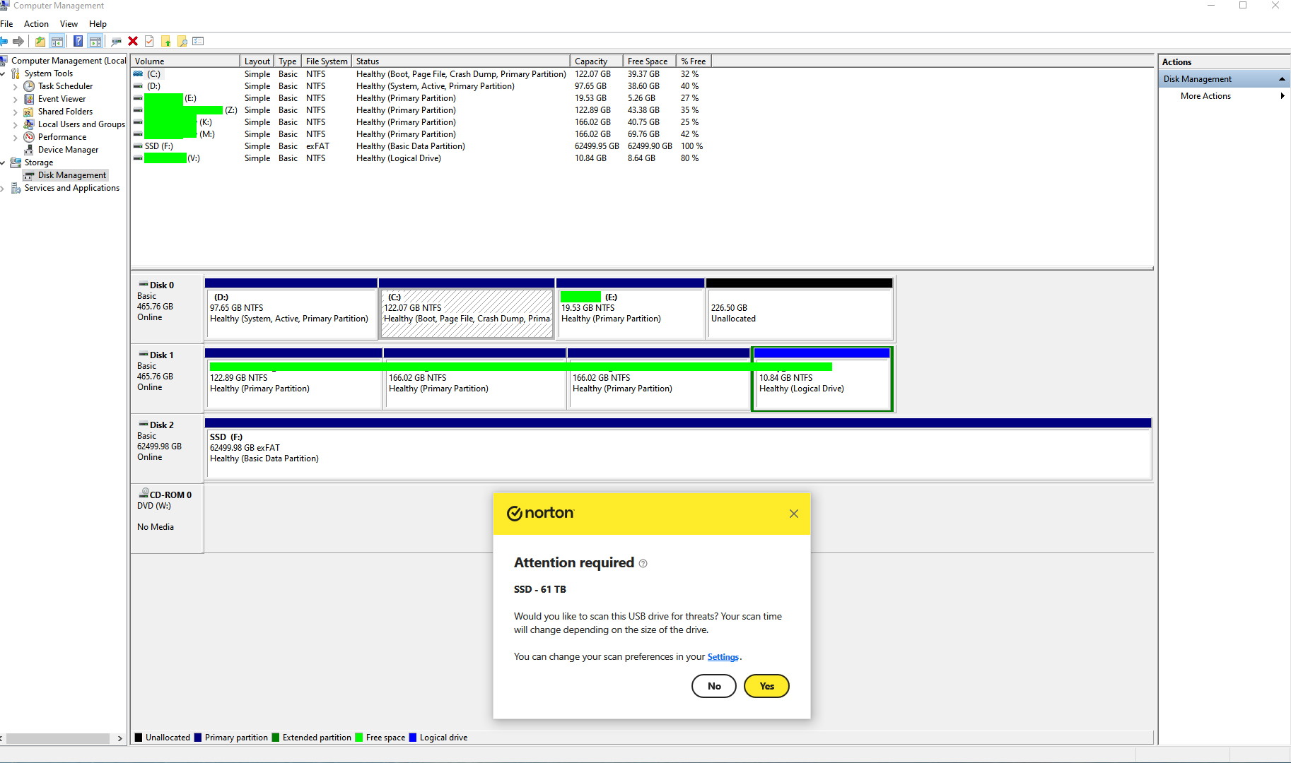

but when did you last buy a 2.5" SSD?
I bought a drive which is 3.3cm wide, 10.6cm long, 0.9cm thick, which is 64 Terabytes,
I dont see how 2.5" drives can remain viable when you can get ginormous capacity like that 1.3"
I am not saying you dont use them nor that they arent useful, I have various I use, just that the technology now is getting so advanced that 2.5" is way too big. that 64 terabyte USB3 drive will fit all the disks I have ever bought,
if I continue with the current plan of complete removal of the HDD cage, then the 140mm should be alright.
Does it say:
PRIME TX-1600
yes
or
no
looks like another purchasing hazard!
looking at the specs, they look pretty much the same!
not having the dedicated connectors does give more flexibility as to which sockets to use eg I could avoid the lowest row whichever way the PSU is placed with the tx-1600, whereas with the tx-1600 atx3.0 the way the PSU is currently, I'd be forced to use the lowest row if I used both. no idea when I would use those leads!
but with the HDD cage removed, the lowest row is no longer problematic!
Personally, i have not seen any drives that operate at 3.3V alone. Researching why SATA cable has 3.3V rail told me that some older SATA1 drives used to operate at 3.3V, hence why it was included with SATA power cables. But for many years (even decade or so), there haven't been any SATA drives, that i know of, that operate at 3.3V.
if you have the energy to study the specifications, maybe the SATA 1 specification requires 3.3V, whereas the SATA 2 and higher might just require it for backwards compatibility, the probable terminology will be "legacy support".
some have 0, some have 2, 4 seems a better number. my car was manufactured 2013, and didnt have any originally.
its something to potentially research, whether they are all the same, or whether there is variation in quality. potentially you could have the supplied ones replaced by better ones without having to cut the car.
I think the outer circle of the sensors is to cover the cut marks!
the height of the vehicle might also matter, I think my car is much lower than the insurance replacement 4WD I used for some weeks (Nissan X-trail). I never had both vehicles at the same time so I didnt compare!
to get my own vehicle back, I handed in the X-trail, and the car hire firm then drove me to the insurance repair place to collect my car.

Of the 6x SSDs in my system, 4 of them are 2.5" SATA III.
as mentioned, I suggest they may be obsolete, because I bought a much smaller drive which is 64 terabytes recently,
and then the M.2 drives.
right at this moment not obsolete, but I think obsolescence is imminent.
no idea how fast the 64T drive is, will benchmark it once the new PC is built. but it does say M.2 on it.
and says "supports hard disk: M.2/NGFF (2230/2242/2260/2280)".

There are several issues when you swap the PSU around;
1. PSU cables aren't long enough for to be routed from outside the PC to the inside.
2. Mains power cable socket would then be inside the PC case. How do you plan to route that inside the PC case?
3. PSU will exhaust all of it's air into PC case (exhaust vents are at the back, where fan control button is).
25th June 2021 because there was a need. (Looked up my PC hardware purchase history.)

yes it is 64TB, I have verified this just now, both Norton and Windows "Computer Management" panel on Win10 have verified this, Norton says it is 61TB, and Computer Management says it is 62499.98GB,
see this screenshot:
http://www.directemails.info/tom/psu/64TB.jpg
and a photo of the item with a ruler to gauge sizes, its literally half of 2.5", ie 1.25",
http://www.directemails.info/tom/psu/64TB_photo.jpg
I wasnt sure if it was for real or if it was a typo of 64GB, but it really is 64TB, that tiny item will fit every hard disk and every floppy I have used since I bought my Amiga 500 approx 1989.
just as 5.25" was superceded by 3.5", and then 3.5" superceded by 2.5", now 1.25" will supercede 2.5"
and the sting is it cost a 2 digit amount, its cheaper than the 2T small Samsung drive I bought about a year ago! basically its an example where China is overtaking South Korea.
in the screenshot, I thought the other drives were 250G, in fact 500G, I think I got a 500G for the system when I shunted a 250G magnetic to a 500G SSD, to ensure it fitted, with space left for Win11, and I shunted the other 250G to 500G when it was starting to become a bit full.
USAFRet
There is no 64TB USB drive.
There is no 64TB HDD.
They do not exist. Period.
You have purchased a fake.
The firmware is altered to report as 64TB.
In fact, it is not.
And at a price in 2 digits? Like...$60?
Not even a little bit.
It is a fake, no matter how much you want it to be real.
