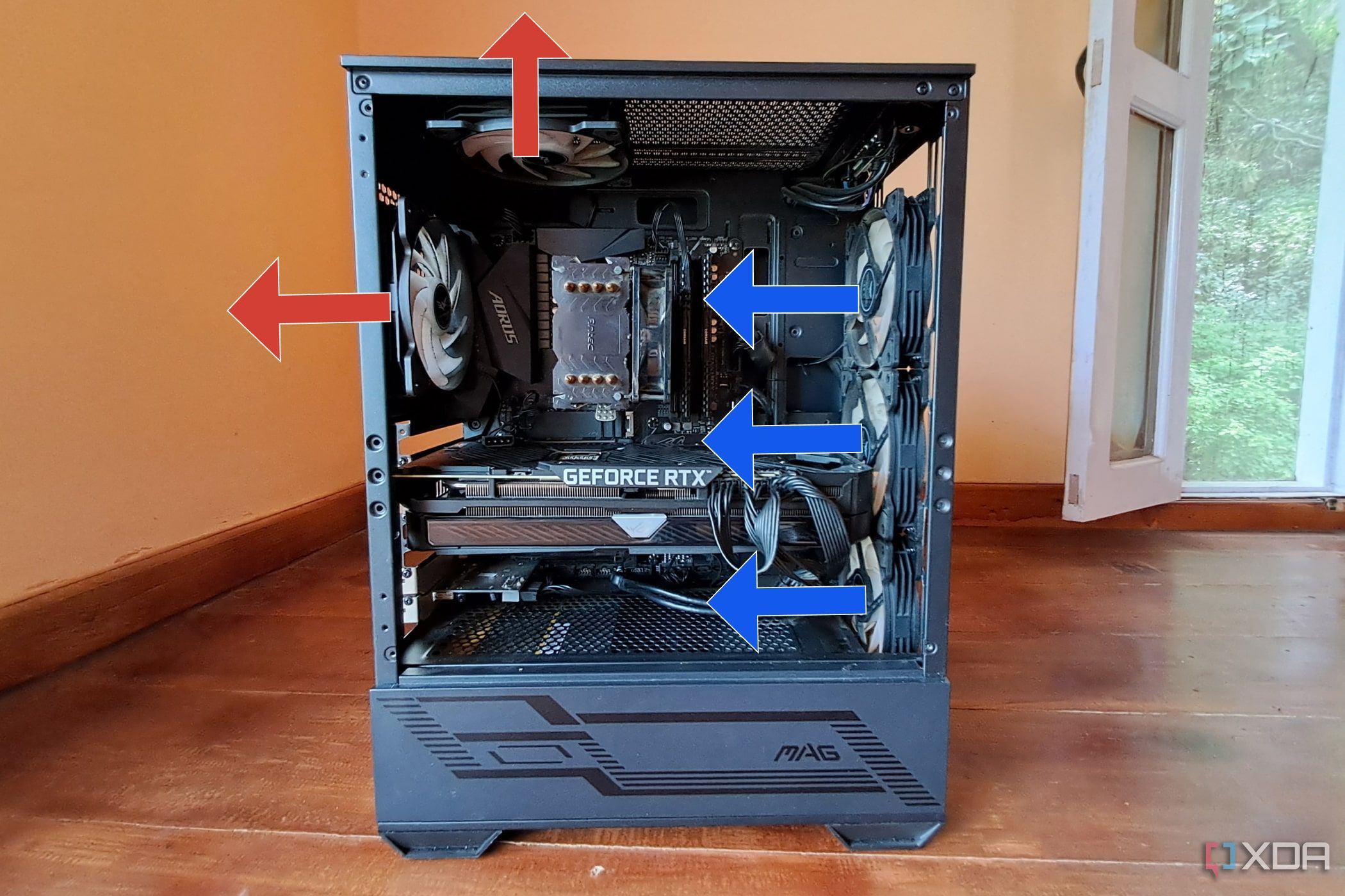

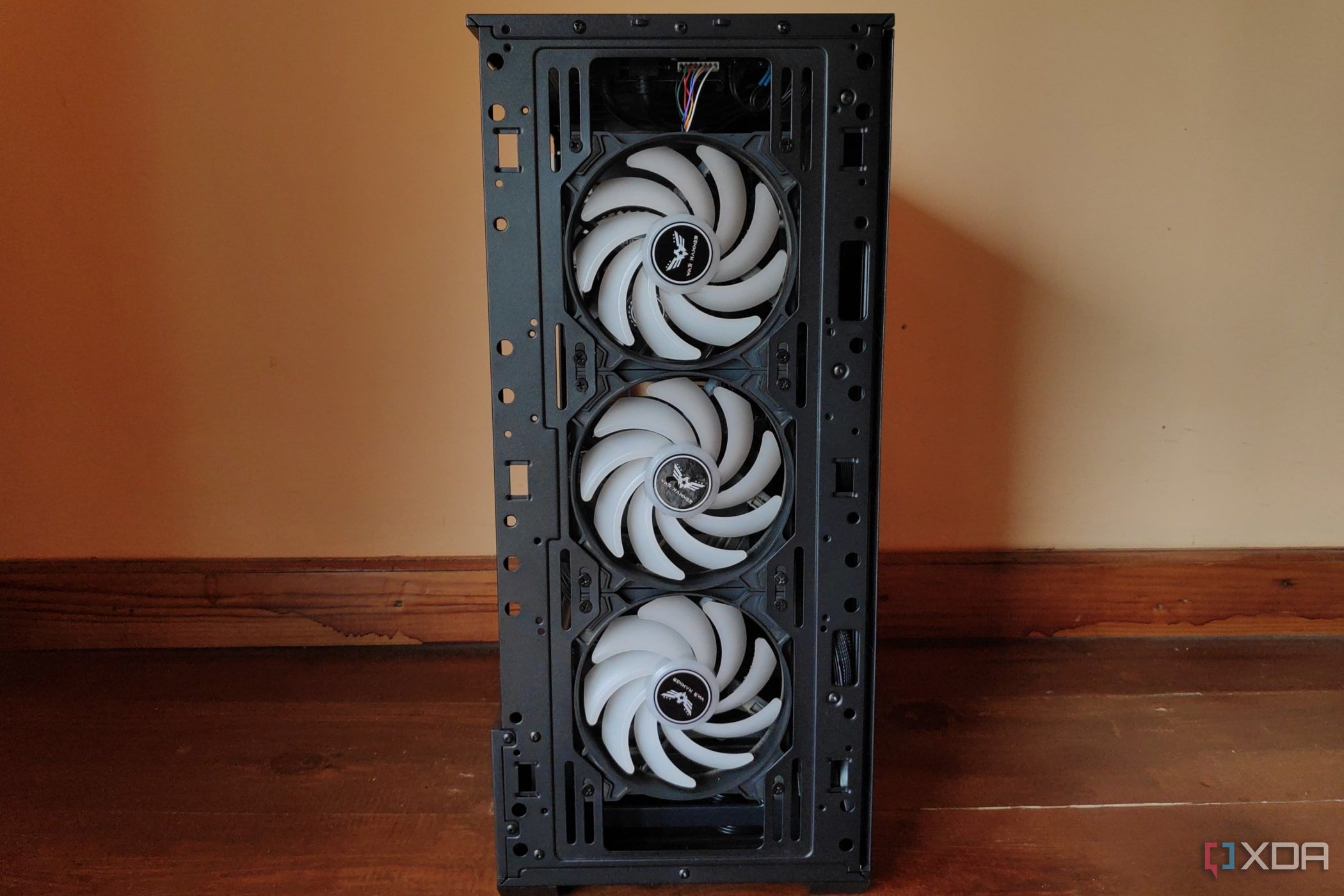

Standard air flow configuration is 2 or 3 intake fans in front and
one rear exhaust fan.

And keep to standard pc case airflow configuration (photo in post #10).
