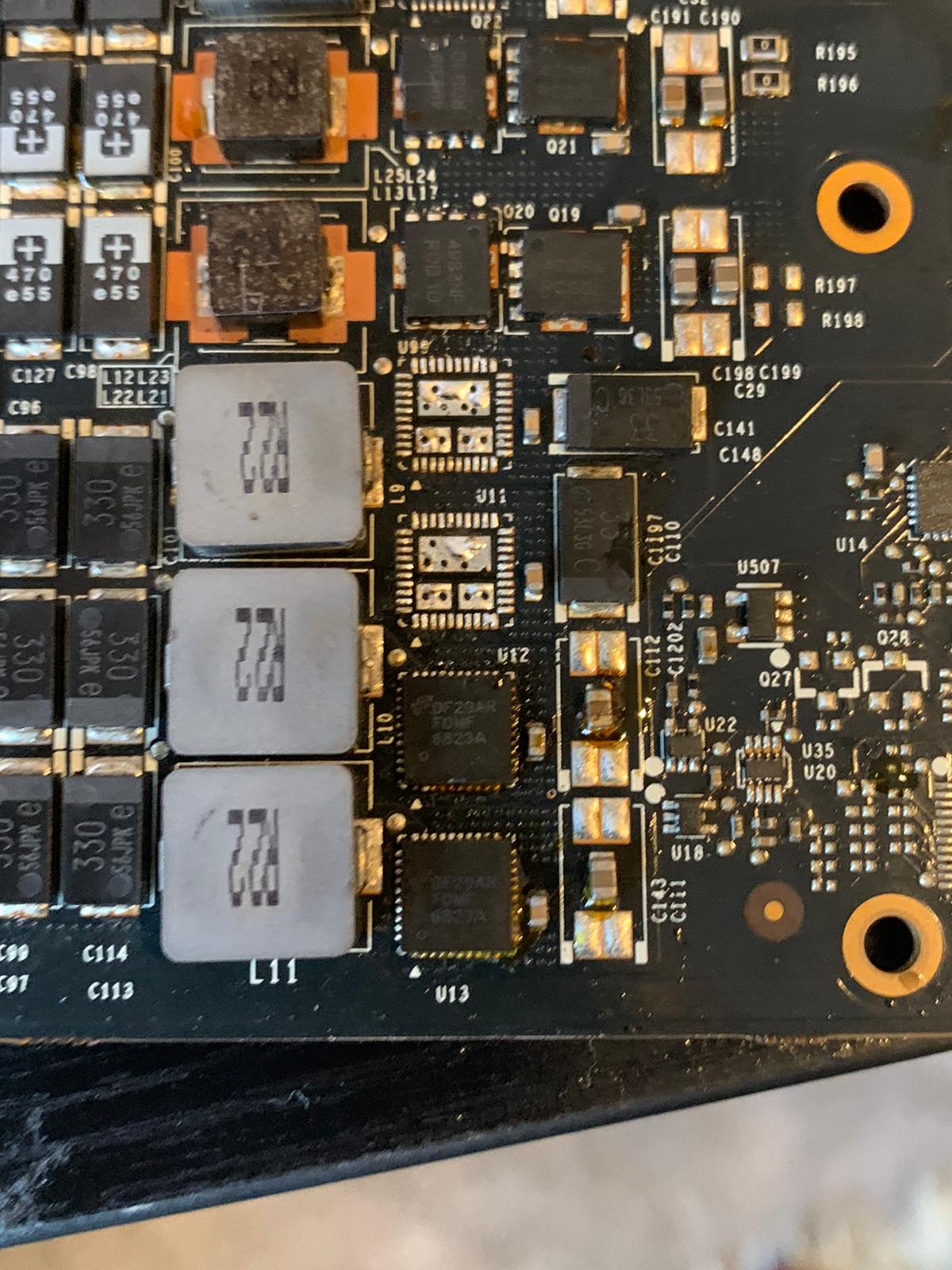

Hello,
I purchased a 980ti from ebay that has a short on the 8 pin PCIE connector.
After days of research and testing I finally figured out it was 2 of MOSFETS were causing the short.
I managed to desolder both of then and HEY PRESTO the graphics card now shows a image and works in windows!
I was wondering if anyone can help me identify and find a replacement mosfet chip the number appears to say - DF29AR FDMF 6823A.
Also how safe is this graphics card to run without the 2 mosfet chips?
Thanks

Oh fantastic that was fast! Thanks so much!
Do you know if its safe to run without the 2 mosfets?
Thanks
The mosfets and the chokes next to them are main components of VRM, each choke is 1 phase, if you remove 2 mosfet your card's GPU only has 4 functioning VRM left. It could work but not as good as it was designed, weird things might happen sooner or later.
