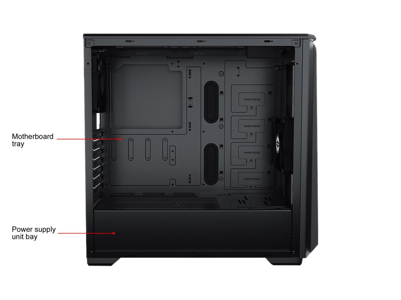

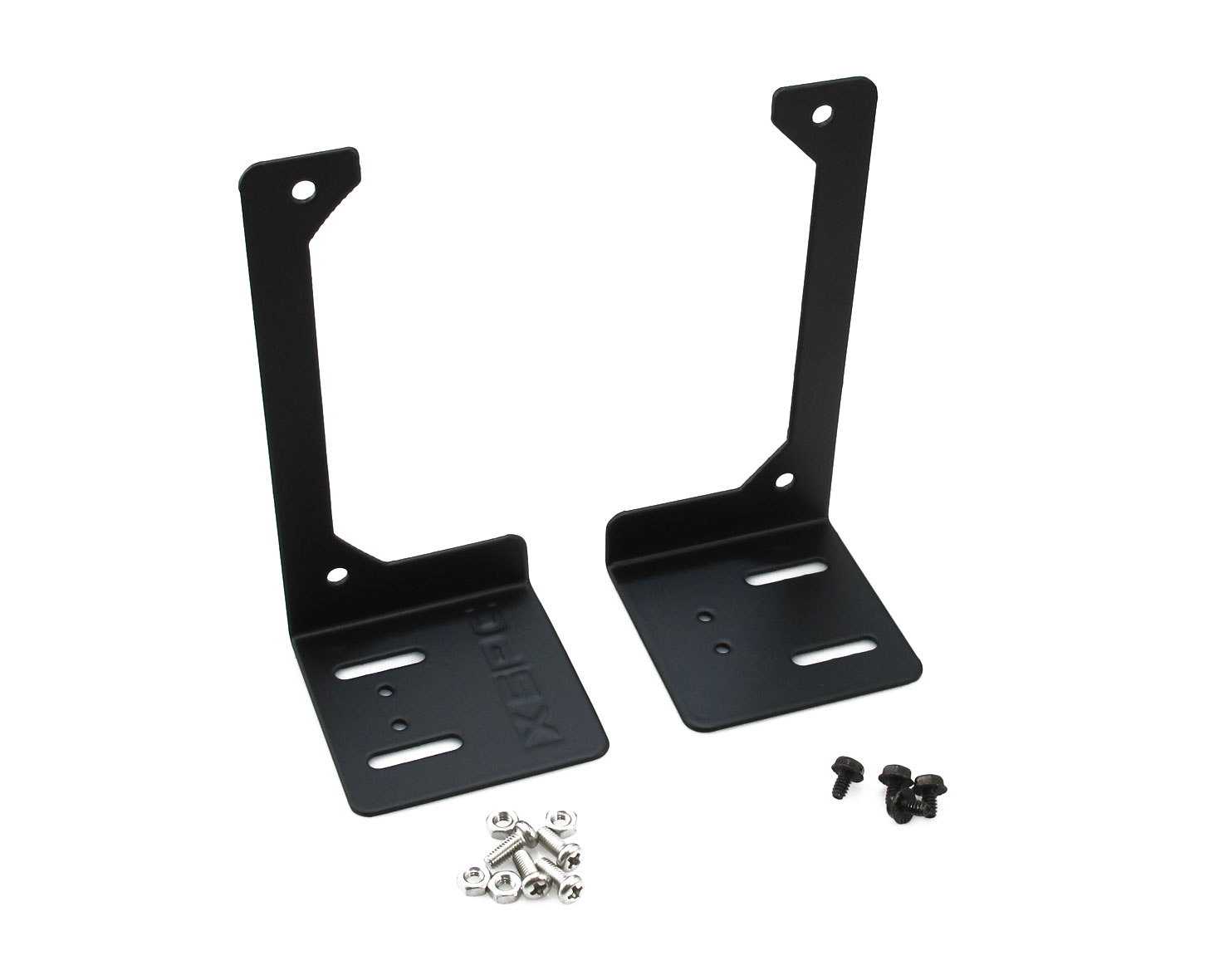

Simply put, I want to attach this
To the back corner on this of this case, the P400a
Those two holes you see is where you screw the tempered glass side on, so I need to drill behind it so I can attach the above brace to it. I will have a 240mm radatior externally mounted pulling air and blowing it across the back of the case so it's always pulling fresh, cooler ambient air. I don't care about looks.
What type of drill bit can get through this? Or is there an easier way I'm not thinking of? Never done this to a case before. Thanks
Edit: Here is a rear view of said case
