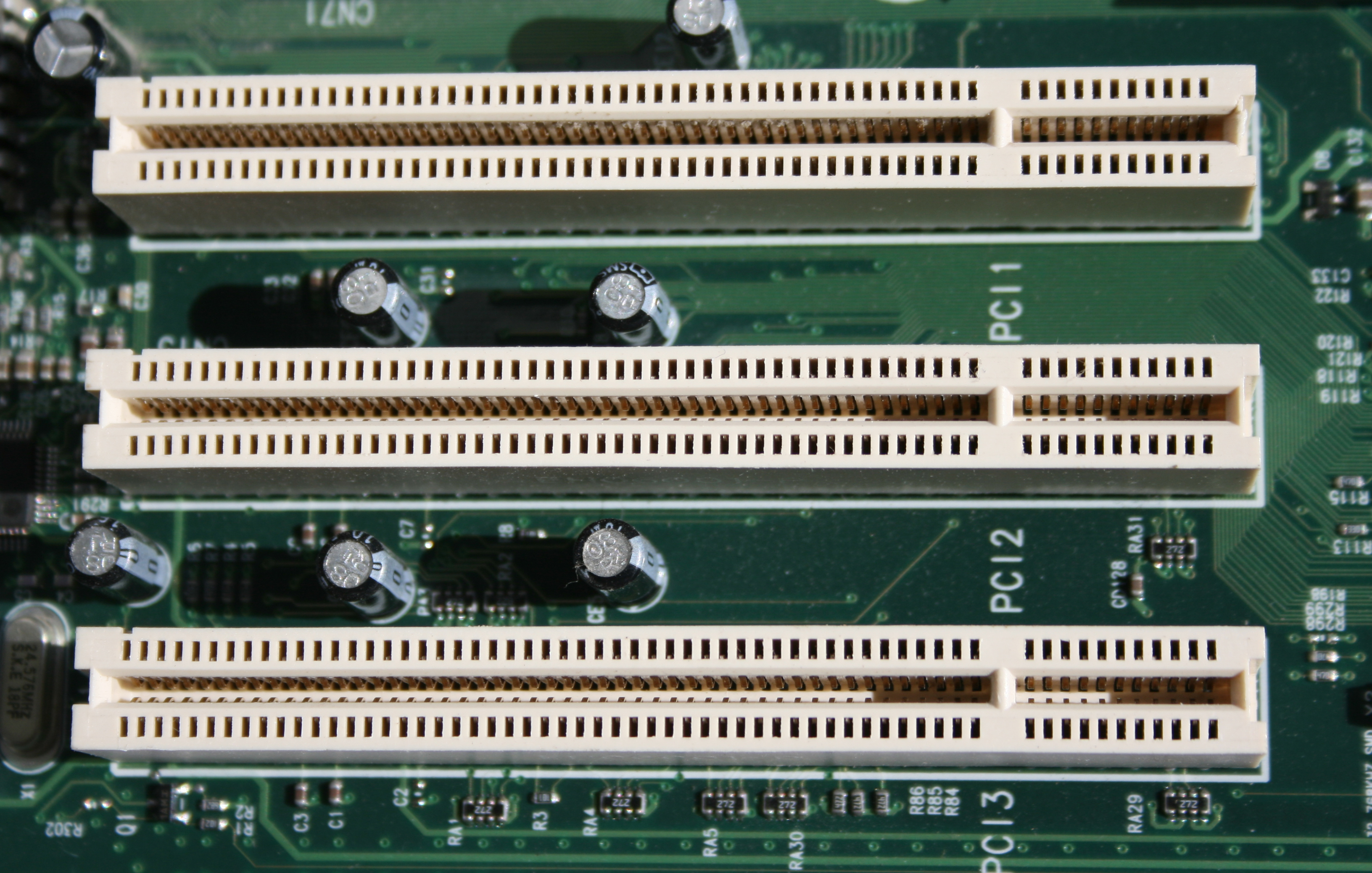

Okay maybe you don't get this one, PCI 3 is like a totally different slot. It's not like PCI-e 1x or PCI-e 16x it has a different distance from the edge of the motherboard and it won't fit in any PCI-e slot. I'm wondering if there's some sort of adapter. I tried to research it, but all I could find was PCI-e 16x extensions.
Are you talking about this slot?
What motherboard do you have?(exact model)
