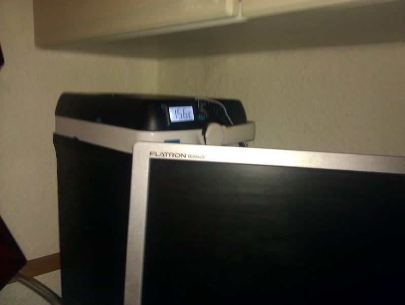

I modded the two fans I bought onto the Lid and threw away the old dual spindle thing,
after a bit of research its a Yate loon M-327 icebox fan, I can't find any CFM specs anywhere so I'm assuming my two 80mm 25Cfm fans are a suitable replacement,
the noise is definitely bearable now hehe
and I modded the Xspc sensor display into a useful location,
I just have to find the time to insulate the tubing and rebuild the rest of the rig lol
**Ok, five hours later,
Ambient is 19.5'C, water in the loop is 20.69'C with all fans on low and the chillers water temp is 13'C
I reckon its had time to balance itself out so I'm saying my chiller gives me a 6'C drop (unloaded ofc)
once its hooked up to the loop and we have heat rolling in there it may drop to a much lower measurement, possibly back up to ambient temps but time will tell,
Don't forget I'm still adamant on the rads getting rid of the heat before it gets to the chiller, and hopefully I'm sat in the margin where my rads aren't working against me by raising the temps,
We shall see :)
Moto
The internal fan just died (condensation inside the cooler probably) so I'm currently just wafting air over the hotsides heatsink,
It was a possible event so not completely surprised 😛
but the hotsides the one to be worried about if the fan fails,

Now you understand why they used the fans they did, right?
This is idling with no heat load at all, it will be a far different story when you add the generated heat from the CPU and GPUs to the water.
You'll get far better results when you finally mount a water block to the cold side of the peltier and directly pick up it's cold output as a matter of fact I think there's someone here with a thread doing just that, wonder who it could be, Oh Well I'm sure it will come to me later! :)
Presently my water temperature is 11c enjoying a 15c idle with my CPU overclocked to 4.5ghz and that's with heat added to the setup, max load temp is 32c.
You might want to let him work the bugs out first, it's not soup yet, and definitely not champagne cork popping time.
