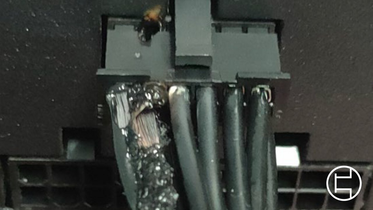

I agree that blaming the customer is not the answer, but he still may be correct about the root cause of the problem. The plausibility and/or correctness of his explanation, as far as I'm concerned, is the standard for judging his credibility. Clearly his expertise is in power supply issues, not customer relations.
His response is one I would expect from technical person. If one wants the PC answer that usually comes from marketing. And I know this because i'm a technical person myself and that is the same answer I would give. EVGA knew this was going to be a problem and they were smart for making an exit and not have NV make them look stupid.
And the blame for this is 100% on NV, AMD was also smart for avoiding this because they saw it coming. So NV knew didn't give a damn and sold it as is because they know they have a fanatical fan base that will pitch a tent infront of best buy and sleep there for nights to get first dibs at anything they release.
If there fans would have said no we are not buying this you can be sure it would have been recalled and resigned already.

The fact that this is still being talked about is crazy. How many reports have been made of burnt connectors? More people have probably tested the problem without replicating than have actually complained.
I am not saying there should not be a warning issued now for users/dyi-ers since an issue has been raised. But I doubt Nvidia is at fault since the cord is built to spec as far as they know. If not it's the cord manufacturer who is at fault.

It has been more than two weeks since the the first 16-pin 12VHPWR melting adapter problem reared its smoldering head. While various third parties and tech experts have come forth with reasonable theories about the underlying issue(s), Nvidia and its partners have been conspicuously quiet.

How is it BS if this could very well be the issue. What qualifications do you have to say otherwise? Again as I have posted before, he blamed nobody. He emphasized greatly that the plug was truly difficult to fully insert to the extent that someone could believe that it is fully inserted when in fact it is not. This is in no way blaming the user, if anything its implying a fault with the design of the connector itself.
The interesting thing is that 12-pin cables tend to insert easier than 16-pin, from personal experience. Given tens of thousands of RTX 4090 cards potentially in the hands of users, is it possible some of them won't push the connector all the way in? I'd say absolutely. Compared to an 8-pin or 12-pin, I probably have to push twice as hard to get the click with 16-pin. So from that perspective, Jonny Guru may be absolutely correct.
I know that every time I test a different 4090 card, I'm double and triple checking that the connection is all the way in. Because for now, that's all I can do short of just not testing the cards, and I'm not ready to do that. Also, if one of the cards I'm reviewing then has a meltdown, I can be sure that it wasn't from an improperly inserted cable.
The thing is that no one will come forward and publicly admit to having "inserted it wrong." All you get is a melted connector and a Reddit post with a picture or two after the melting has occurred. Does that mean for sure that every melted connector is from user error? No. But the lack of complaints from the past two years of 12-pin cables and adapters does make the whole situation rather suspect. It's either manufacturing errors that only affect a few adapters (including direct to PSU cables), or user error on insertion, or both.
To include another for the list of potentials, the port itself on the card could be the issue in one of the cases. I used to work in quality control at an aerospace company and even with very tight manufacturing tolerances and high quality materials used to make a product you still always get 1-2% of products getting rejected from being sold and get recycled due to defects. I cant imagine the manufacturers of the ports and cables are near 100% quality in their manufacturing.
1-2% for finished, fully-assembled products that managed to slip through QA. The connectors are only a single component of such a product and if you count everything down to SMD resistors, then you need a ~0.003% individual component failure rate to hit that 1% premature failure rate on finished products.

I believe there may be a subset of people that may not have connected the power connector firmly. But his explanation is unlikely to cover all the scenarios because I am pretty sure we have seen experienced reviewer/ testers running into the same issue. Some blame the cable quality, some connector quality, some says you cannot bend (not even a little bit), here we see poor connection, etc. All these just shows there is no conclusion as to the root cause. Whatever the root cause, I do feel that this connector in its current form is a fail and don't go well with high power draw, even though it is created for this purpose. The reason why I came to this conclusion is because when you have these many exceptions/ potential points of failures to use a cable, and some in which you have no control over, it just don't sound right nor safe to use. This incident reminded me of the infamous Apple antenna gate where Steve infamously said, "you are holding it wrong".
Many "experienced reviewers / testers" have COMMENTED on the issue and shared their thoughts on what they think the root cause might be but I am not aware of any of them having personally witnessed or reproduced it themselves yet.
