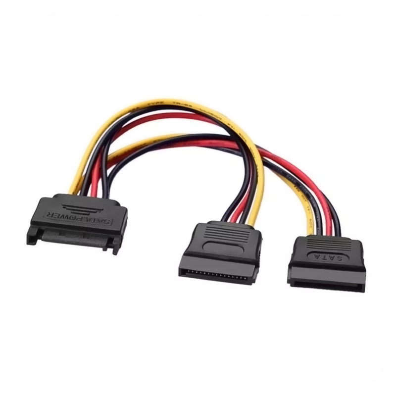

I bet that's why they gave me this in the box and you just enlightened me as to why... Thanks I'll try this right now. Was about to get the clippers hahaha.
How thoughtful of them!
