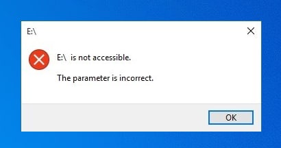

So, I gave my hard drive to a friend because they needed the movies on it. When i got it back, i realized it did not work. Plugging it into all my ports plus a usb hub made no difference. It would show the led indicator blink like 5 times, and just stay on. Checking task manager, i saw that every few tens of seconds, it read/wrote like 100kbps. It also did not have the custom name i assigned it in the file explorer, and was wrongly labelled E:/ drive instead of the D:/ drive i would normally see it as. Trying to access the drive, i get an error sayin the parameter was incorrect or something similar:
Checking the Device manager under storage devices, i saw the name of the hard drive. Opening Disk Management, It would not loadup and in the bottom corner, it would say unable to connect to the virtual disk service. Testing for the same symptopms on my second laptop, I got the exact same issues.
I read online that some smart Tvs change the hard drive's format, so i tried the Hdd on my "non - smart" Tv, and it worked perfectly. I could navigate and see my files still there, and i could access them all, just not on my laptop for some reason
I really REALLY to get all the files back intact, as i have like $300-$400 worth of stuff on it. Please Help!!
