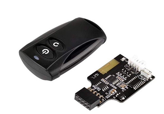

If ambient noise is an issue then that is a possibility and the easiest way to go about it. As far as turning it off that is something I never do, I make use of Sleep and Hibernate and set up a time where they are on for windows updates when I am asleep. I do however have this installed on my HTPC/NAS server in the basement just in case.
SilverStone Technology 2.4G Wireless Remote Computer Power/Reset Switch $25
