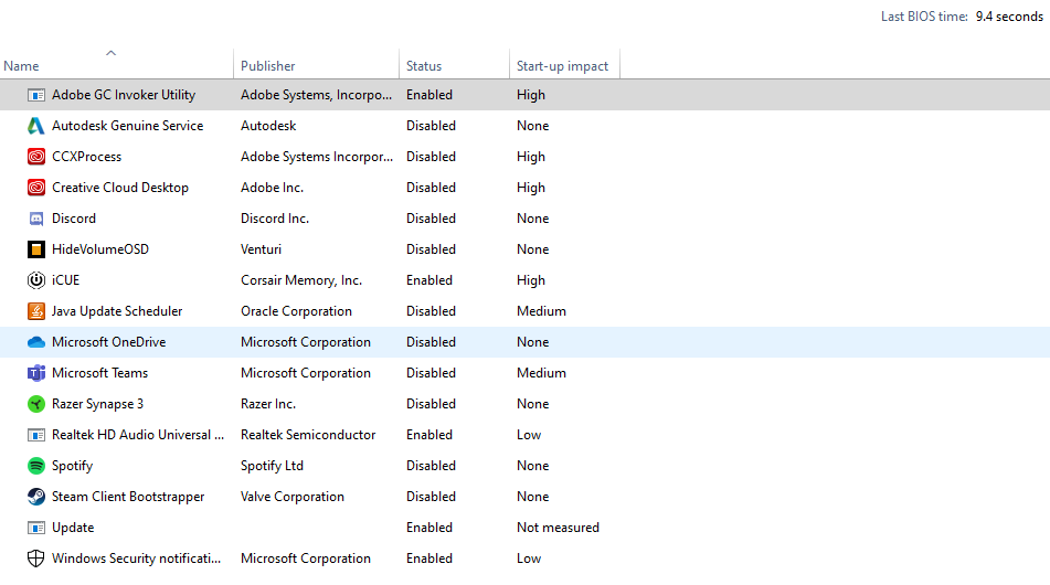

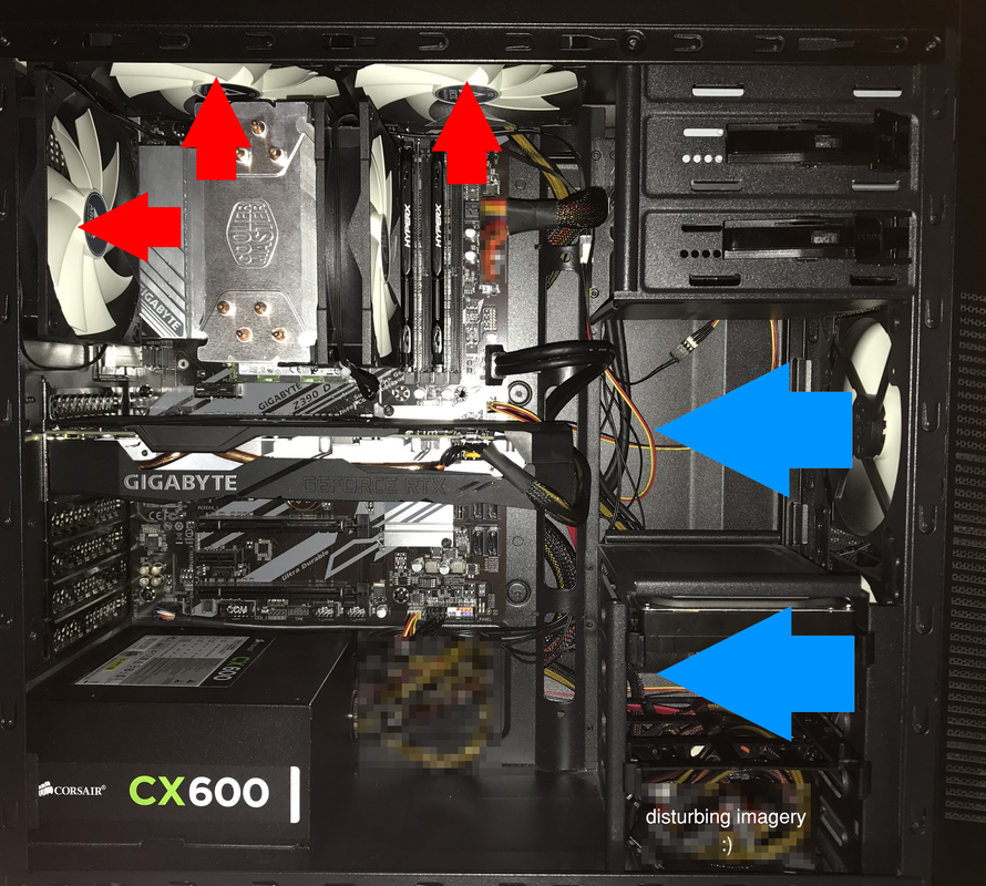

I have a neutral case air flow (image attached), despite this it's common for my CPU to idle at 40°C - 45°C on warm boot, and my GPU at 45°C - 50°C, although this is probably down to my quiet fan configuration. I also have a pretty restricted list of start up apps (image also attached), and have recently dusted my pc, re-seated all components, and re-applied thermal paste.

Quick tip. That first top fan is not doing a good job with the air coming from the front. It's exhausting cool air from the front before it's at the CPU. Probably half the air from the front fan is exhausted and half of air goes in your CPU cooler fan. I normally don't setup fans if they go past the CPU at the top.
Would you say I could fix this by just reversing the direction of that fan or would this cause more issues?
Mar 24, 2020
11
Just unplug it and see what happens.
After about 10 mins of COD:MW, I'm seeing an improvement in temperatures.
My CPU peaked at 60°C, staying between 50°C and 58°C most of the time. Before this I would note a max temperature of 70°C - 75°C, although I would have been playing for longer than 10 mins.
However, my GPU still managed to peak at 81°C.
I also didn't notice any frame drops, I'll try out No Man's Sky and RDR2 to see if I get similar results.
You should see an improvement. If you look at my amazing paint skill below you will see that the fresh air from the front fan is escaping BEFORE it goes in the CPU fan.
View: https://imgur.com/a/h3rdLlK
Thanks for the support with this, I'm pretty happy so far although I still need to test other offending games. Just out of curiosity, would reversing the fan I disconnected to pull make any more of a difference?
Also, after testing No Man's Sky there is still noticeable stuttering, although this seems to have eased a bit (may be placebo).
On the other hand RDR2 is running much better, I can finally sink some hours into this game!
The problem in reversing that fan you unplugged would be that the air it will bring in will be the air exhausted by the fan beside it. So warm air. If I were you I would let that fan unplugged. :)
Okay sure thing, thanks for the thermal tips! Do you think other games which haven't seen an improvement so far are due to poor optimisation or are there any other glaring issues you can spot?
