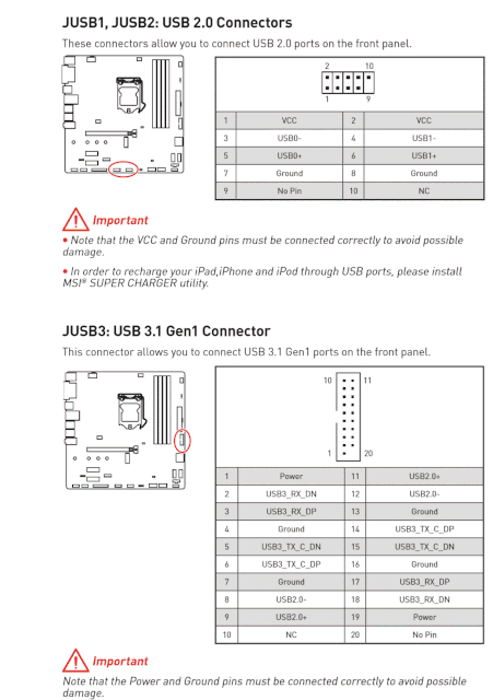

I installed the thermaltake floe ring into my pc with no issues and turned the pc on, but noticed that the lights werent working on the cooler. I shut down my pc, plugged in the cable properly into the rbg controller and now my pc wont turn on at all. Does anyone know what the problem could be? I've checked the psu cables and made sure everything was plugged in properly and still nothing... please help

I don't think i bent any socket pins, the only thing i touched was the cable going into the jusb2 slot in my motherboard because the rgb wasnt working. Then when i tried to power it on the whole system flashed for a second then didnt boot.

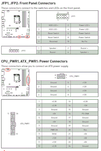

I would try one more time, outside the case with bare minimum (CPU and one RAM stick). Just to see if it powers up.
While outside the case, power on by shorting the power connectors with a flat screwdriver.

this may seem like a stupid question, but how exactly do i do that? I can't seem to find the power pins anywhere
