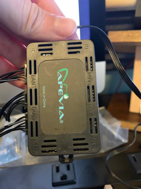

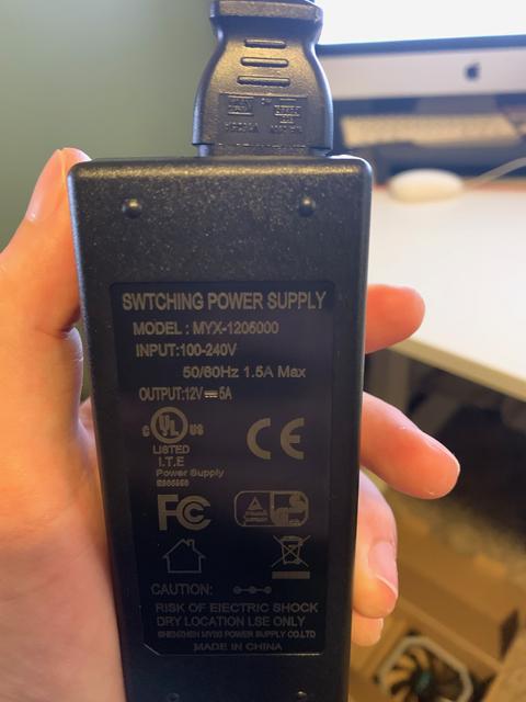

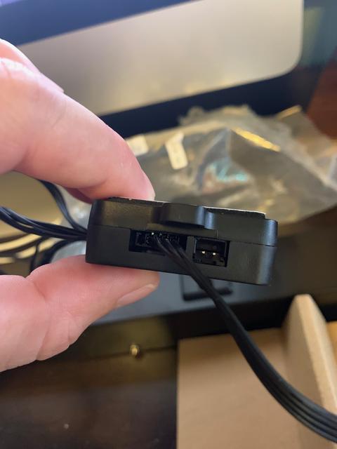

Hey everyone,
I am a bit of new guy here when it comes to PC related stuff so thanks for taking the time to try and help me out.
What I am trying to do here is I am building a custom monitor riser for my desk and want to install some RGB fans on it to help circulate air flow in my office (I work from home and have 3 computers running at the same time so it get's hot).
I bought these fans: https://www.amazon.com/dp/B07S4CRG9W/ref=nav_timeline_asin?_encoding=UTF8&th=1
-- And I bought this adapter: https://www.amazon.com/dp/B002TJNDU4/?tag=tec06d-20
I attached the controller to the 4 pin molex adapter and all 6 fans were running at what seemed to be full speed. But the LED fans and the 2 LED strips were not lighting up at all. I double checked the remote and I knew it worked because it was turning off and on another LED strip I had, guess it ran the type of remote control.
Do I need to purchase this to make them work as well or am I interrupting this wrong? The controller does have this 3 pin port but wasn't sure if this was needed or not.
-- https://www.amazon.com/dp/B000BSJGL0/?tag=tec06d-20
-- would these pics help?
Thanks.

What you did originally is right, so if it's not working there is a flaw or some small detail missed. The central box with that set is both the power supply and the display controller for the fan motors and the RGB lighting units in each fan. It gets all its power from the 4-pin Molex input. The hand-held remote box merely sends lighting display control signals to that Controller / Hub, so if you can get the fans to run using that remote unit, it is working. I note the description of that system says the remote control can NOT change the speed of the fans. You do NOT need that last adapter.
However, I suspect the problem is a little different. Fan motors use a 12 VDC power source. The Addressable RGB lights in them use a 5 VDC power source. (There are other different RGB lights that use 12 VDC.) A 4-pin Molex output from the PSU has four wires to it and together they supply both 12 VDC and 5 VDC on separate wire pairs. Unfortunately the particular power supply module you bought has only the 12 VDC part, and nothing supplying 5 VDC. So I suspect that the Controller / Hub is simply not getting any of the 5 VDC power it requires to run the lights, but is getting the fan's 12 VDC supply.
What you need is a different power supply module. I did not find any like what you have - a simple closed box with a 4-pin Molex output female connector and both power outputs. But I did find a power supply box that has screw terminals on its end and sufficient current capability at both voltages simultaneously to fit your needs for those six fans. To use it you would have to connect to its terminals a grounded 120 VAC power input cord and the leads from a FEMALE (with 4 holes) Molex connector, then protect that terminal end from exposure and accidental contact. If you are "handy" at these things, you can do it with the right parts. First you need the power supply, like this
https://www.amazon.com/MEAN-WELL-RD-65A-Output-Enclosed/dp/B005T7EZM8/ref=sr_1_3?crid=KU76995P66J1&keywords=power+supply+12v+5v&qid=1564151953&s=gateway&sprefix=power+supply+12+V+5,aps,208&sr=8-3
NOTE that the seller says that Amazon has posted on that page the wrong photo, and the item they are selling really does have outputs of 12 VDC and 5 VDC.
Then you need a grounded AC power cord, which I'm sure you can get. Then you need a cable with a female 4-pin Molex connector on one end. The easiest way to get that is to buy a 4-pin Molex Extension cable, like this 12" long model.
https://www.amazon.com/Female-Extension-Adapter-Sleeving-Connectors/dp/B00Y738MN8/ref=sr_1_10?crid=37H112R5W7SZF&keywords=molex+extension+cable&qid=1564153049&s=gateway&sprefix=Molex+extension,aps,196&sr=8-10
Check the power input connector on your fan set Hub - I fully expect it is MALE with 4 round pins inside a shroud. So on the Extension cable you would snip off the male end leaving a FEMALE connector on the wires, and secure the correct wires to the correct screw terminals of the power supply box. Correct? Well, the proper pinout for a female Molex connector is the first item here
http://wiki.robotz.com/index.php/PC_Power_Supply_Voltage_Data_and_Connector_Types#Four_Pin_Molex_Power_Connector
So the YELLOW wire goes to the power supply unit's +12 VDC terminal labelled +V2, Red goes to the + 5 VDC (+V1) terminal, and the two Black leads go to the two "COM" terminals.
Good luck!
