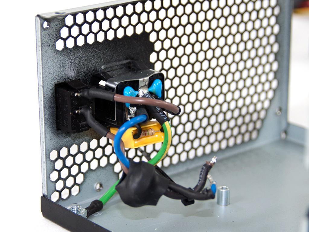

Inside an ATX PSU, you often find several X-Class and Y-Class high voltage capacitors used for transient filtering, soldered to the back of the inlet connector. There may be more X/Y capacitors on the main printed circuit board too.
https://www.techpowerup.com/articles/overclocking/psu/160/3
X-Class capacitors are connected across Line and Neutral.
Y-Class capacitors are connected from Line to Chassis and from Neutral to Chassis in the PSU.
In the photo above, the Y-Class capacitors are the two small blue discs. The X-Class capacitor (with parallel bleeder resistor) is the larger yellow component.
If the PSU chassis is not earthed, the leakage currents caused by high voltage transients will have nowhere to go and the metal case will just "float", electrically speaking.
