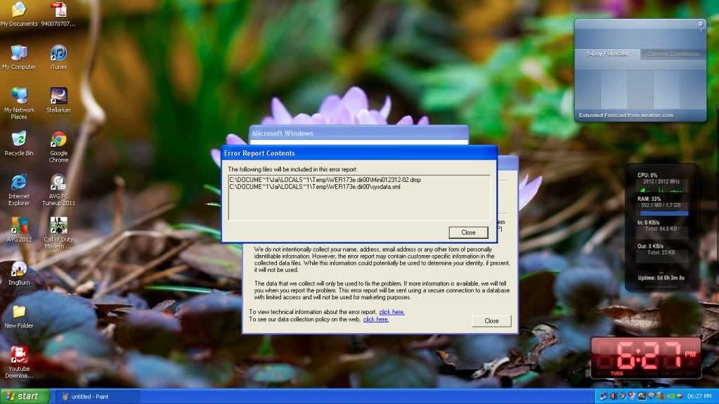

Hi jacquith ,
i installed my graphics card some days back and it worked fine for a day and again i started getting the same old problems again .My pc started restarting on its own with no error messages , so i removed my graphics card and it worked fine for a day and now today when i switch on my pc , it said the same ol report as "the system has recovered from a serious error .
the screenshots and details are as follows ,
http://i1171.photobucket.com/albums/r547/jaigopal/untitled-1.jpg
http://i1171.photobucket.com/albums/r547/jaigopal/untitled2.jpg
I Got the two following errors :-

i have completely no clue regarding this issue 🙁 , please help me as to how to proceed with this problem
thanks in advance

the screenshots and details of the errors are as follows ,
http://i1171.photobucket.com/album [...] tled-1.jpg
http://i1171.photobucket.com/album [...] itled2.jpg
Error code 0000001a, parameter1 00041284, parameter2 01fcb001, parameter3 0000715f, parameter4 c0883000.

i have completely no clue regarding this issue , please help me as to how to proceed with this problem
thanks in advance.
