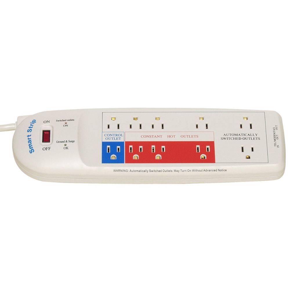

Since my last addition to the cooling setup of adding the 3rd peltier switch controlled and on it's own power supply, many times I almost screwed up and shut down the computer and forgot to cut off the 3rd pelteir assemblies power, and that is bad, Really BAD!
Without the main machine running which powers the pumps there would be no water flow, and the peltier still energized would freeze the water in the water block and literally split it open!
Seeing as how I came close a couple of times to forgetting to cut the power, and one time I had already left the room and remembered it and went running back, and shut it down.
I decided to just add the 3rd peltier assembly to the 1000w power supply that already controlled the other 2 TEC assemblies, which automatically starts and stops when the main computer does.
I didn't do it in the beginning of adding the 3rd TEC assembly, which I should have!
But?
I was not sure the 3rd TEC assembly was going to do what I had hoped it would? (Which was to hold a certain water temperature when running Intel burn Test, which it does! :) )
I was reluctant to splice it into the main cooling even after discovering the 3rd TEC worked as hoped, because of how much work was involved in tying it into my existing cooling setup, which took the better part of a day as there was much wiring and rewiring that had to be done.
So now the 3rd TEC assembly is wired into the main cooling setup properly, and on it's own switch, and when the main computer is powered down, so is the 3rd TEC assembly, so if I had forgot, and left it switched on, no worries!

On a side note, now that you're already done with all the work 😀, you could have just tied a 5v coil relay to a molex connector off your PSU, put your original power in to the switch side of the relay, ran the power from that to the manual switch you have now. Turn off computer, no more power to switch!
Just an idea I've been floating. I'm going to use the exact above setup, except with the ground and enable wire hooked to the relay to turn on my second PSU for my cooling box when I hit the power switch for my computer.

Next, I am going to buy a switching power strip the will turn the peltier power supply on automatically when the computer is on, and this 110V temperature relay to turn the power supply off and on automatically when the water gets close to dew point. Will help save on power cost too.

You'll have to let me know how the temp controller works long term. See if there's a hysteresis that you can program. I was in the same boat as you, temperature controlled peltiers. But after doing a whole bunch of reading I found out that they are pretty sensitive to thermal cycling and break down quickly. I ended up making my own PWM controller that controls a voltage regulator I built to try to limit the on / off. I still don't even know if it was worth it...... But it's been a fun ride as I try to get it all figured out!

Can you link the power strip you are going to use? Right now my current plan is to power up a relay off of the 5v from my computers PSU and have that relay control the enable switch for another PSU. A power strip might be a simpler answer....
Hello Ruwed,
Yes, here is the power strip I have used in the past.
http://www.amazon.com/Smart-Strip-SCG5-Autoswitching-Technology/dp/B000L9FQUO/ref=sr_1_6?ie=UTF8&qid=1431557762&sr=8-6&keywords=power+strip+energy+saver
I lost it when I moved to my house somehow, so I will need to purchase another one. Basically it has a "control" plug (blue in this case). When the control plug is energized by having the computer on, it will activate the other plugs (not colored ones). The 2 red plugs in this example are always hot. It is also adjustable via a simple screw driver on the side to adjust sensitivity. Hope this helps.

Interesting device that would have saved me some trouble if had discovered it existed earlier! :)
So the blue is the control plug that whatever is plugged in there and powered up, the red plug sockets power up as well, is that how it works?
Sweet! :)
Ryan, basically. The blue is the sensing plug. If you have something plugged into it and it flows enough electricity (depending on how you set it) it will turn on the other ports. The red ports are ALWAYS hot.
This larger picture might help. But yes, you got it.

OK I see, the picture I saw was so small you couldn't read the labeling, that is cool! :)
:ouch: I can't say I'm too comfortable with that warning though!
Warning: Automatically Switched Outlets May Turn On Without Advanced Notice
That would put it in a not rock solid dependable category for me, especially if it was energizing a power supply directly controlling the TEC assemblies and came on all by itself without the pumps running, that would be bad, really bad! :pfff:
The reason I use a single 12v rail PC style power supply dedicated to powering the TEC assemblies is when I power the main PC it auto jump starts the 2nd power supply using a dual power supply linking cable.
It allows one motherboard to power 2 independent PC style power supplies simultaneously.
http://www.newegg.com/Product/Product.aspx?Item=9SIA2971AW2565
And It is rock solid dependable!
And you just cannot beat the convenience of pushing one button to start it all up, and when the main PC powers down, so does the 2nd power supply controlling your TEC assemblies.
