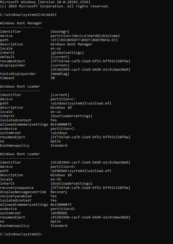

Tried fixing the bcd info for the clone HDD so I could try booting from that and see whats going on with the 2tb nvme.
I can not get the HDD to independently boot. However, somehow I was able to make it so I can boot the HDD through the 200gb nvme...
Image: 'bcdedit' after booting into cloned HDD through 200gb nvme

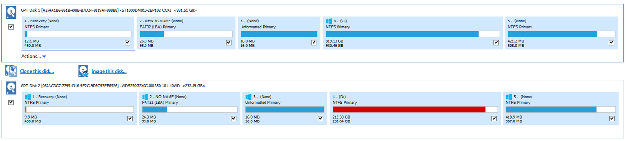

Image: Disk 1 = cloned HDD, Disk 2 = 200gb nvme with old windows installed

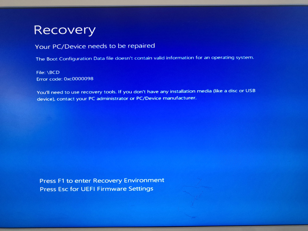

Image: When trying to boot directly from cloned HDD
![bcdedit.png](/proxy.php?image=https%3A%2F%2Fi.postimg.cc%2FD0y8Yv9K%2Fbcdedit.png&hash=5766273a9b0e8d6b7f8f1c224f8ae6c6)
![disks.png](/proxy.php?image=https%3A%2F%2Fi.postimg.cc%2FZnBhqX3d%2Fdisks.png&hash=745c8d8ac8609f974a60c30e4b249781)
![IMG-20210927-091844.jpg](/proxy.php?image=https%3A%2F%2Fi.postimg.cc%2FKzYLMnyd%2FIMG-20210927-091844.jpg&hash=2df0bbb89078469263f5652906531cfa)
