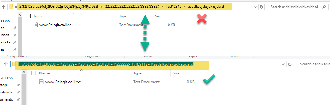

You can check the path and just try to shorten it if no matter about the structure , but if this over (+50) or you matter about the structure this will be a high load on you ,
- Also may be trying to troubleshoot with the capability to solve the problem via this link
https://social.technet.microsoft.co...cters-in-windows-2012-r2?forum=winserverfiles
- and the last choice is to use softwares that can handle this issue
-and I found a thread here talking about solving this issue , I hope it will help

Reduce the path length.
It is almost certainly due to multiple levels of subfolders. And then maybe a disturbingly long filename at the end.
"3rd Quarter Human Resources Report_SatelliteSite_3_First Draft.docx"
(nested within 5 subfolders)
Possible fix?
No idea of how well that might work, just something I found.
Not sure if its related but max file path is 255 character limit.
I encounter this prob at work when unzipping zip files with heavy/long folder structures in network project folders already with long paths.
As simple work around i bring it as close to root of drive as possible and unpack & work on them there.
