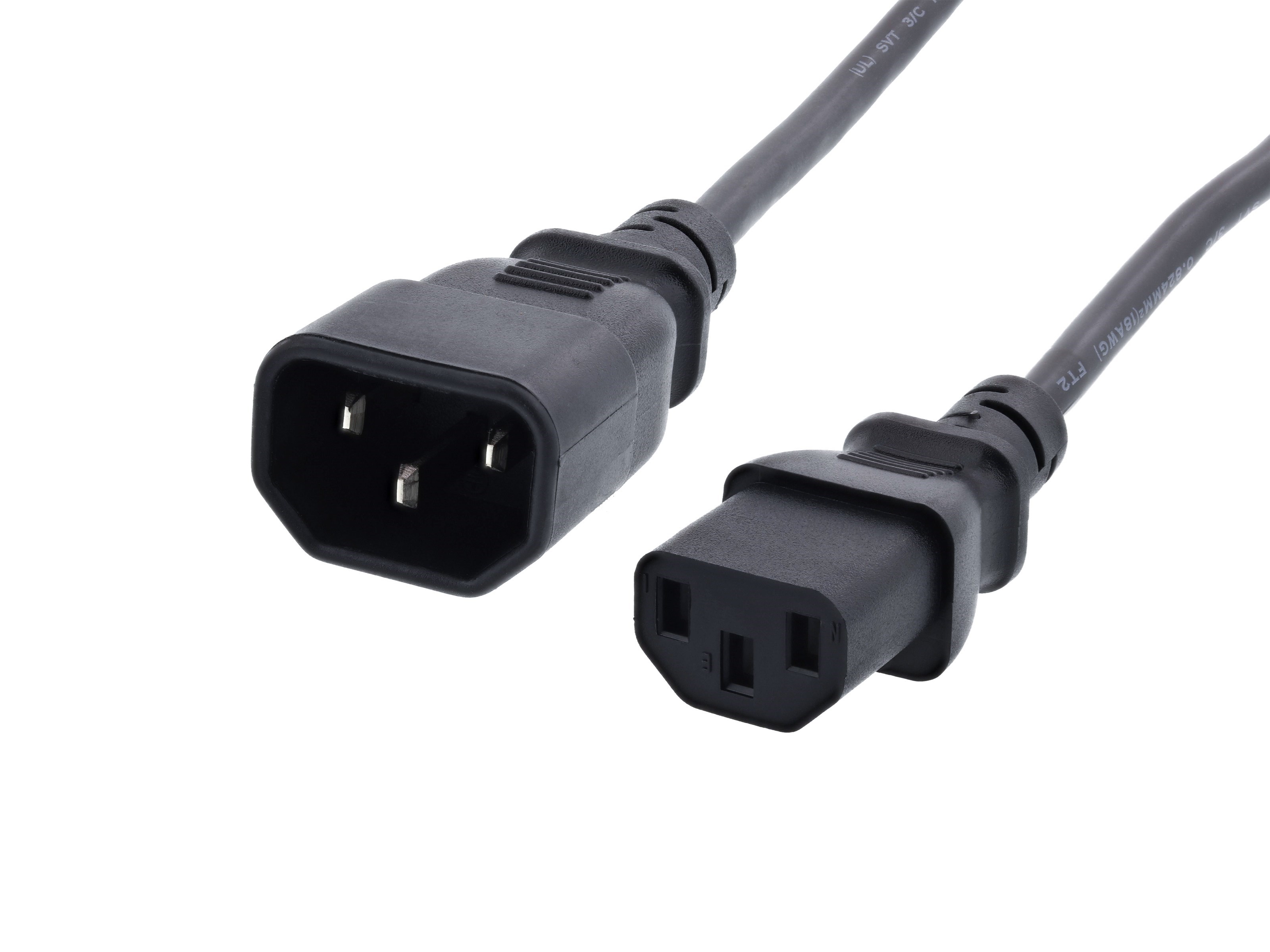

Does that mean any normal power cable like this will work? View: https://i.imgur.com/vpwuBVv.png
Yes.

You can go to any electronics store or amazon and buy the cable. Just look up IEC power cable. The three prong IEC has been the standard switching power supply input cable for as long as I can remember and I have been doing this since the late 80s.
