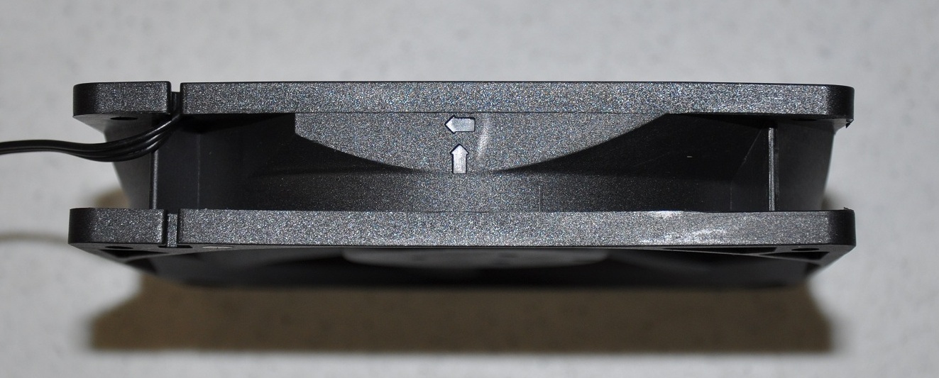

Wait, so i replace the rgb fans at the front with the AIO Cooler, then replace the fan at the top with the 2 rgb fans? But where should the fans be facing, like are there a indicator or arrow to show where the air will be blown to?
This is standard airflow direction diagram.
There are direction arrows painted on fans.
